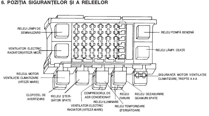

mosoru Posted September 20, 2006 Share Posted September 20, 2006 De la un timp incoace imi tacane un releu pe sub bord(cred ca cel de accesorii) si in acelasi timp creste turatia de mers in gol la 1500-1600,se opreste tacanitul revine turatia la 900 si tot asa. Are cineva idee cam despre ce ar putea fi vorba? Link to comment

ovi_jer Posted September 21, 2006 Share Posted September 21, 2006 Incearca sa depistezi prin atingere cu mana care releu tacane. Link to comment
mosoru Posted September 22, 2006 Share Posted September 22, 2006 Este releul cel mai inalt cum bagi mina sub bord,al 2-lea din dreapta,nu stiu la ce ajuta pt ca figurile din manualul de service sint complet diferite de realitate. Link to comment
ovi_jer Posted September 22, 2006 Share Posted September 22, 2006 Cel de la stergatoare? Link to comment
mosoru Posted September 23, 2006 Share Posted September 23, 2006 Este releul cel mai inalt de pe linia aia,o fi de stergatoare,nu stiu. Link to comment
ovi_jer Posted September 24, 2006 Share Posted September 24, 2006 Scoate releul acela si vezi daca mai face. Banuiesc ca ai ceva probleme din cauza unui contact imperfect. Link to comment
