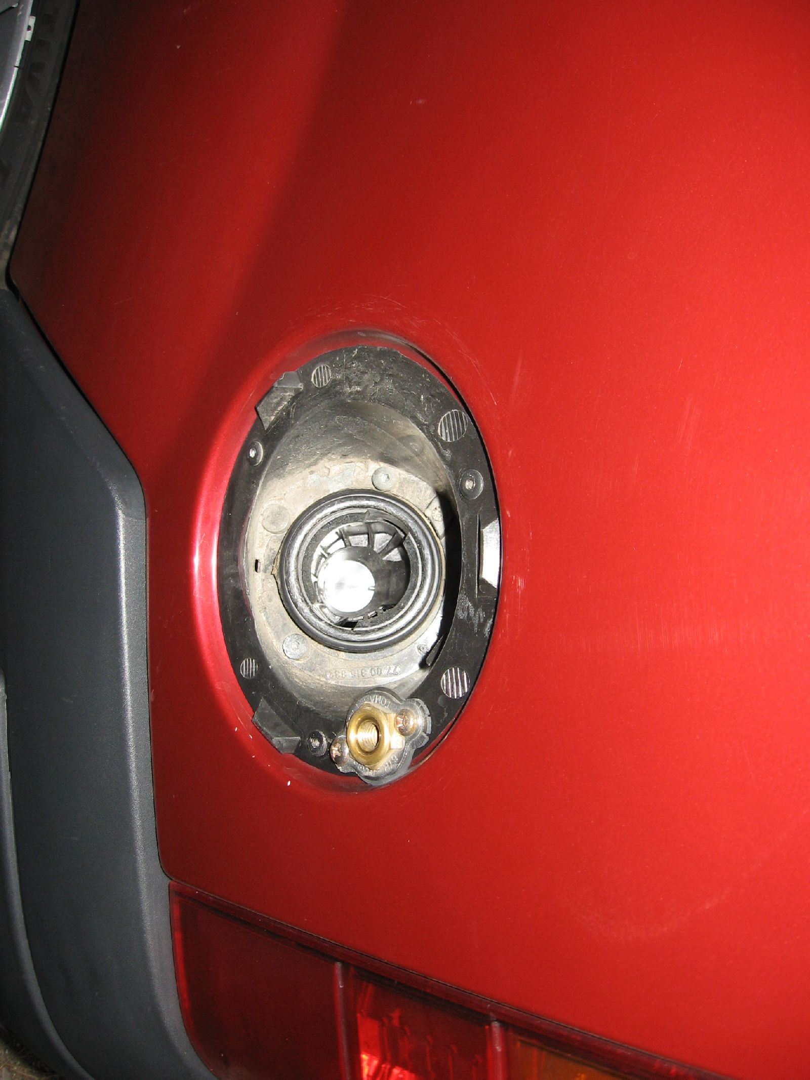

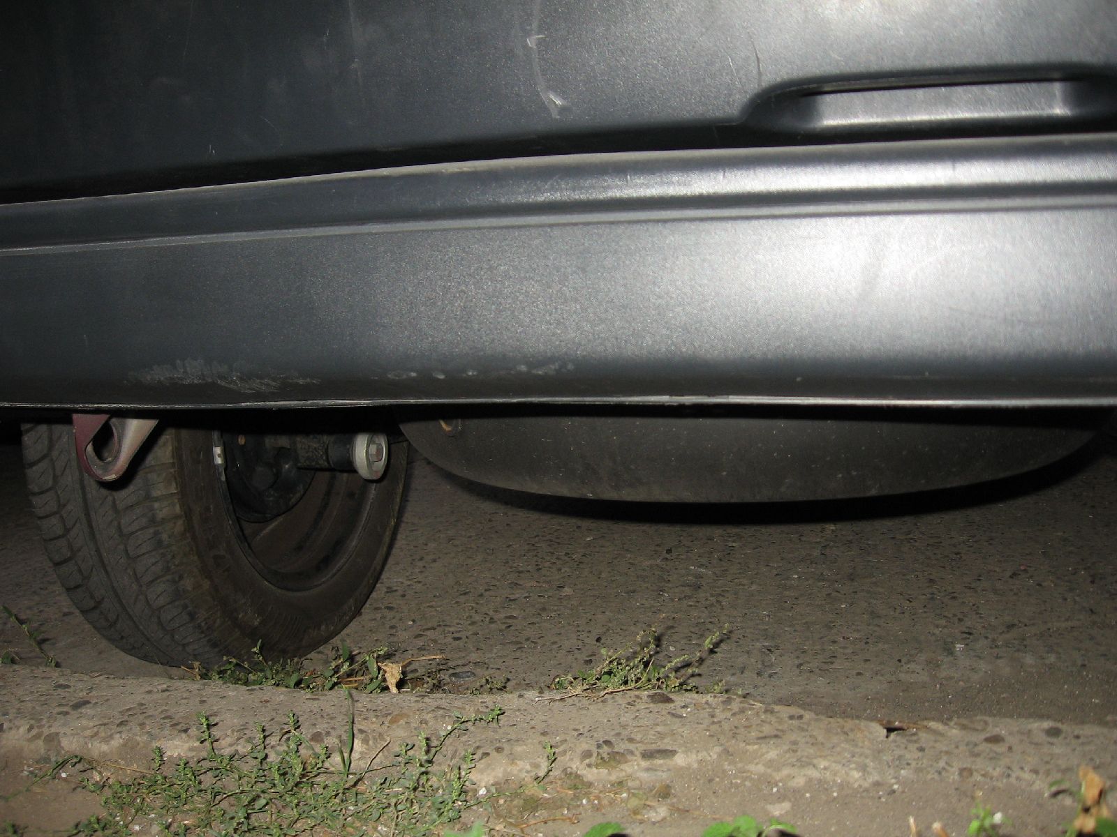

andreib Posted September 16, 2009 Author Share Posted September 16, 2009 (edited) Rezervorul este intradevar toroidal de exterior (adica e sub masina) si are 42 l (cam 36 la umplere max). Poze la instalatie voi face cand voi avea timp... Nu e nimic deosebit la montaj, doar ca toate sunt fixate corect la locul lor (nu atarna nimic balalau ca la montaje romanesti). Si era sa uit, are si borcan pt flashlube valvesaver care momentan e gol... Edited September 16, 2009 by andreib Link to comment

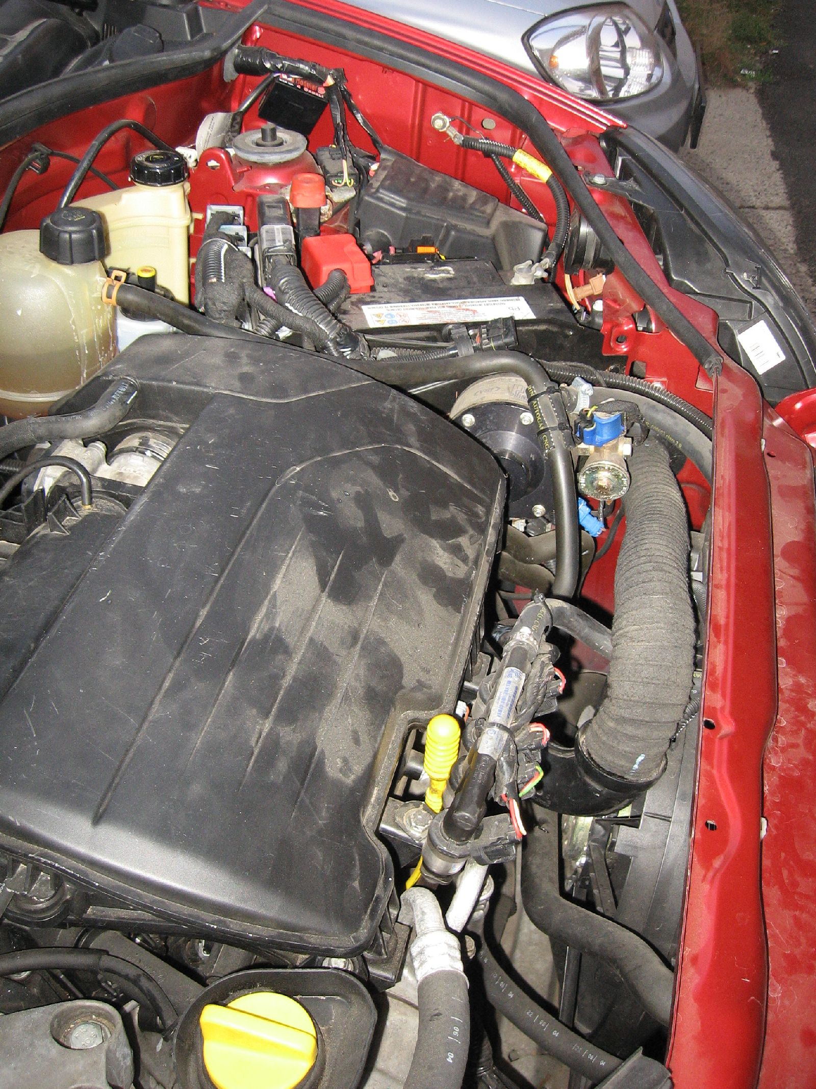

andreib Posted October 3, 2009 Author Share Posted October 3, 2009 Si poze cu motorul si instalatia de GPL Prins VSI. Link to comment

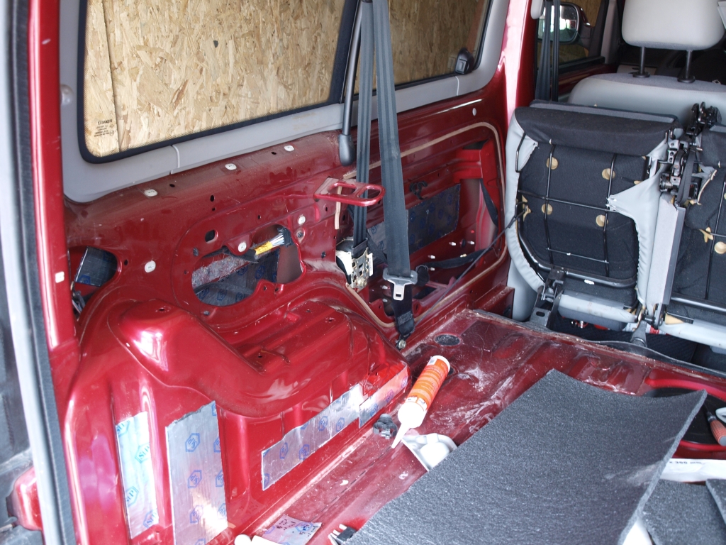

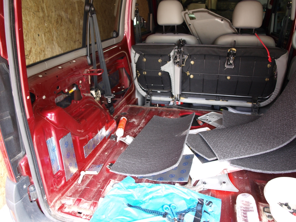

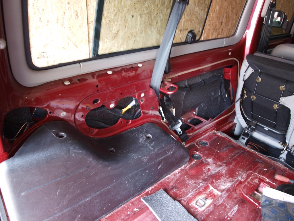

andreib Posted July 31, 2011 Author Share Posted July 31, 2011 Deoarece la 90-100km/h intra caroseria in rezonanta cu evacuarea bondaru al'mare a primit o insonorizare cu STP si material minune marca Salex. Interventiile importante au fost in partea din spate si la aripi. In partea din fata (podea, portiere) era f bine izolat asa ca interventia a fost minima. Acum e mult mai liniste in dubiță. Link to comment
VAXXi Posted July 31, 2011 Share Posted July 31, 2011 Nu-i asa ca merita efortul ? Ce-ai facut cu siliconul, ai lipit buretele pe panourile laterale ? Link to comment
andreib Posted August 1, 2011 Author Share Posted August 1, 2011 Am incercat, dar l-am aruncat repede si am trecut la prelandez. Si da, merita efortul cu varf si indesat . Link to comment
