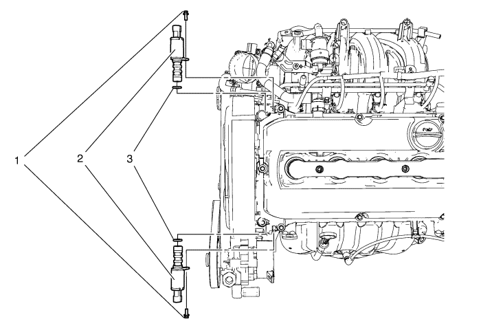

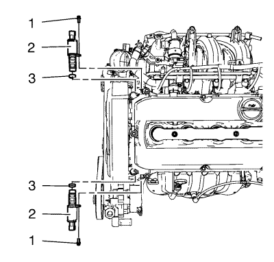

pomo Posted April 28, 2012 Share Posted April 28, 2012 Am avut si eu aceasi problema, pe tester a aparut codul p00011 intake camsofht movifold range performance adica randamentul sistemului de poziţionare a arborelui cu came de admisie (sunt 2 electrovalve care controleaza distributia) .Banuind ca de vina a fost benzina, au curatat electrovalva de pe intrare. Masina a mers 1 zi dupa care s-a aprins iar lampa lui aladin,din nou la service le-au curatat iar dar pentru verificare au fost rotite intre ele si nu au mai fost probleme.Dar atunci am consumat si toata benzina din rezervor. Parerea mea este sa rogi mecanicul sa curete acele elecrtovalve si daca chiar este sigur ca trebuie desfacuta distributia sa o faca,oricum nu ar strica sa daca poti sa mergi la 2 reprezentante,pentru o a2a opinie. Mai bine consumi niste benzina decat sa desfaca motorul aiurea. Bafta. Link to comment
pomo Posted April 29, 2012 Share Posted April 29, 2012 (edited) Aici vei gasi explicatii in legatura cu functionarea distributiei variabile de pe Cruze si implicit despre cum functioneaza cele 2 electrovalve : Circuit/System Description The camshaft position actuator solenoid valve - intake and camshaft position actuator solenoid valve - exhaust are attached to each camshaft and are operated hydraulically in order to change the angle of the camshaft relative to crankshaft position. The camshaft position actuator solenoid valve - intake and camshaft position actuator solenoid valve - exhaust are controlled by the engine control module (ECM). The ECM sends a pulse width modulated signal to a camshaft position actuator solenoid valve - intake and camshaft position actuator solenoid valve - exhaust. The camshaft position actuator solenoid valve - intake and camshaft position actuator solenoid valve - exhaust can change the camshaft angle by a maximum of 20°. The ECM increases the pulse width to accomplish the desired camshaft operation. Edited April 29, 2012 by pomo Link to comment
