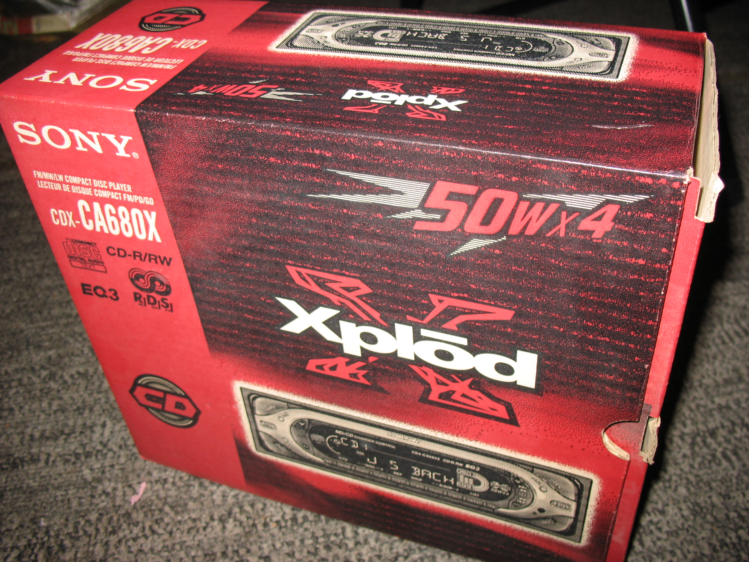

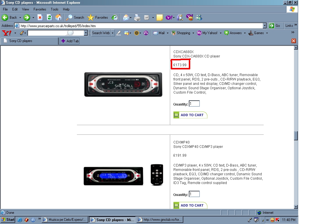

uskt2005 Posted December 13, 2006 Share Posted December 13, 2006 (edited) Mi-am luat si eu cd-ul din imaginea atasata , dar am o problema - l-am montat , merge , toate bune, in schimb nu am bass asa cum avea casul original, ce tipuri de boxe se potrivesc pentru acest model de asa natura sa am si eu bass ceva mai puternic ? Mentionez ca acum am boxele originale ale masinii Multumesc anticipat Edited December 13, 2006 by uskt2005 Link to comment
guru Posted December 13, 2006 Share Posted December 13, 2006 Regret ca trebuie sa te dezamagesc, dar cu acel Xplod, nu vei avea bass. Are un egalizor destul de firav, si nici nu are functia "Loud", care accentueaza frecventele joase. Link to comment
uskt2005 Posted December 13, 2006 Share Posted December 13, 2006 Daca e atat de naspa cum spuneti mai multi de ce draq costa atat? vre-o 10 mil in lei vechi Link to comment
