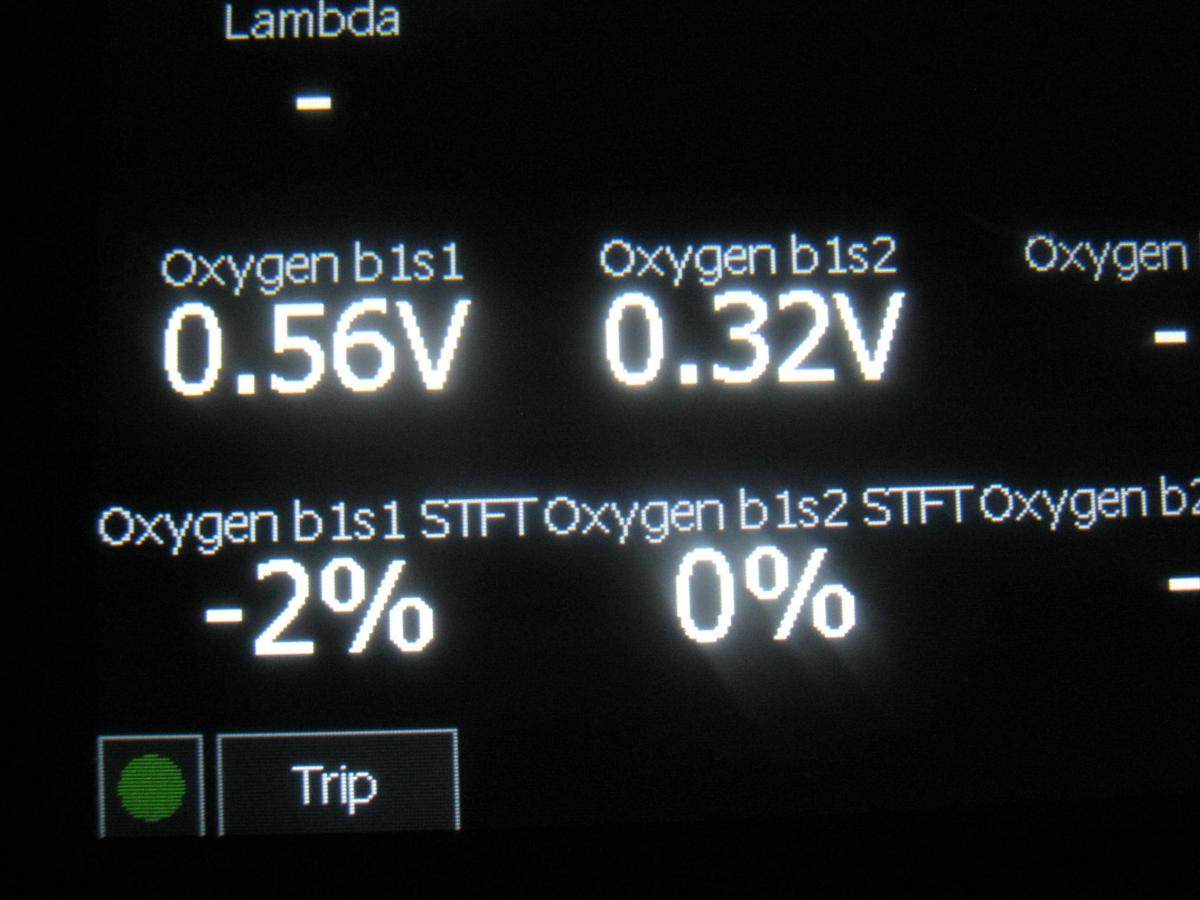

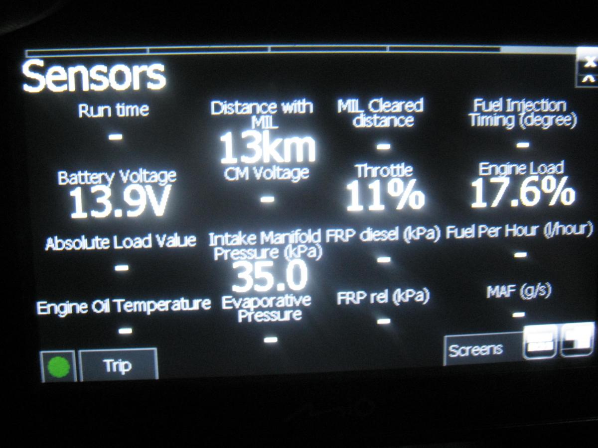

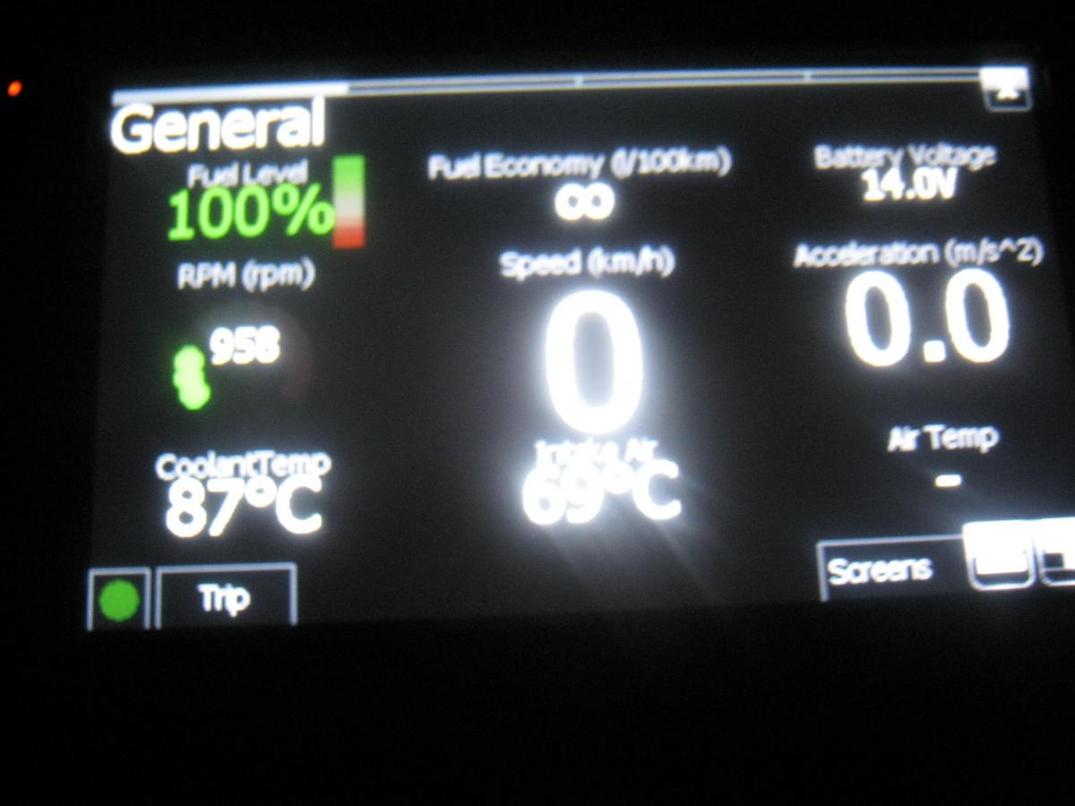

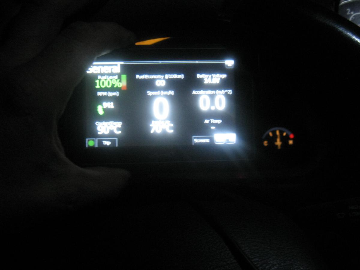

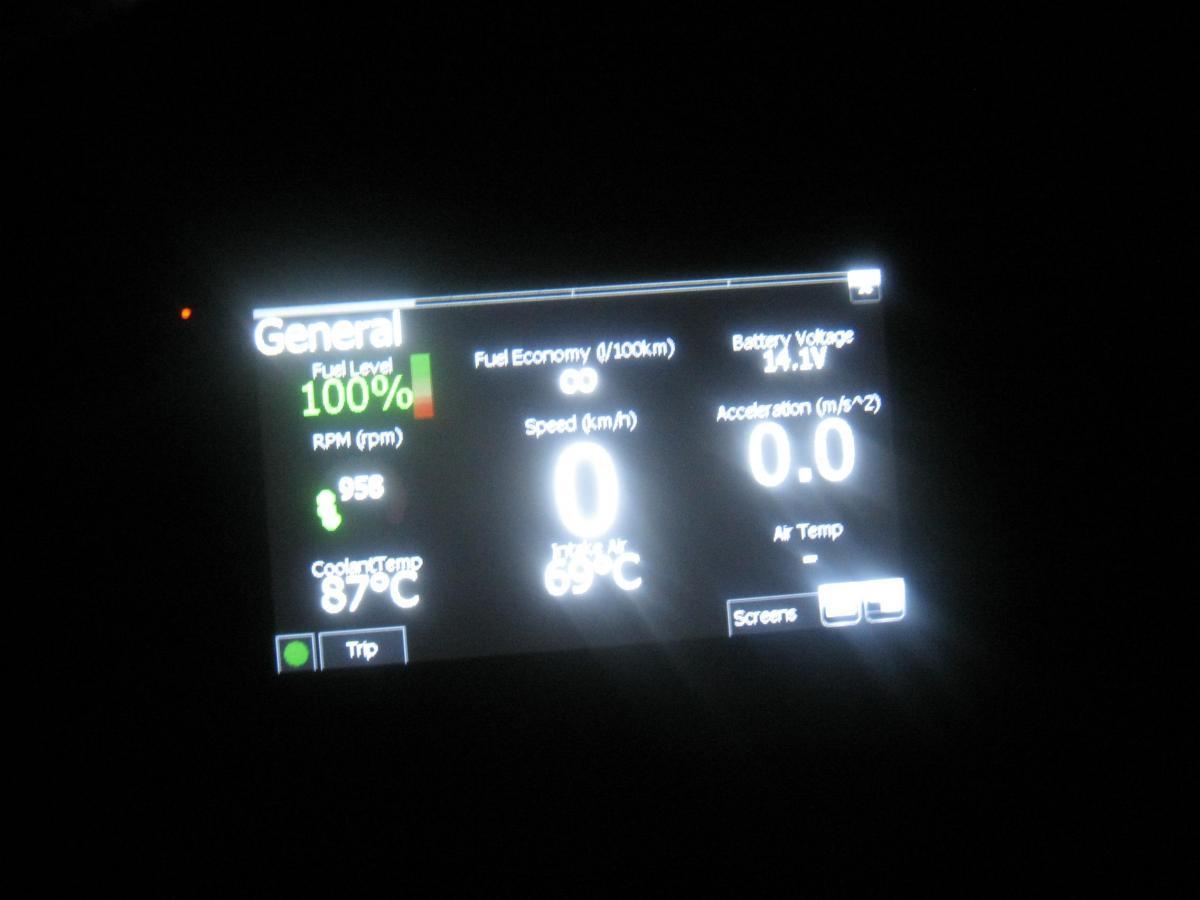

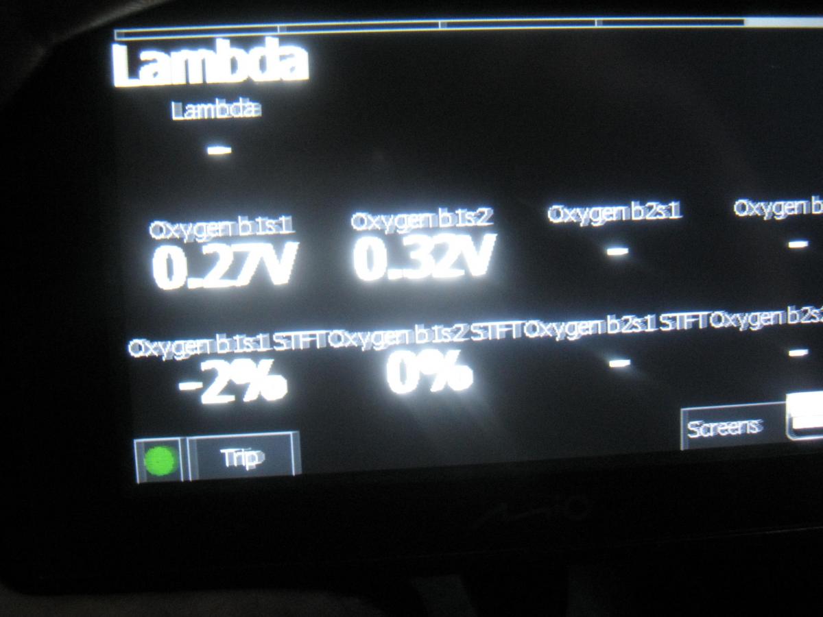

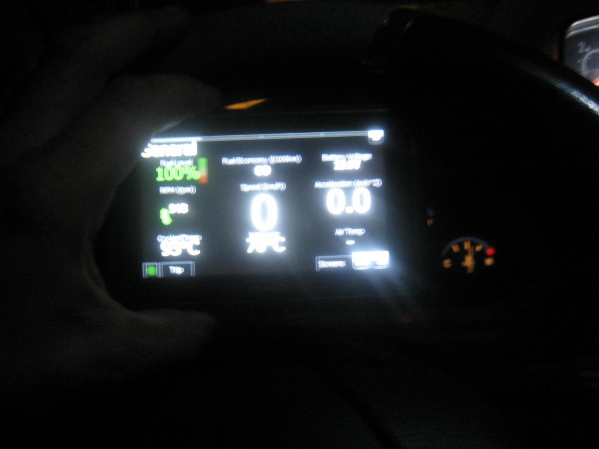

augustinionut Posted May 2, 2013 Share Posted May 2, 2013 (edited) Printre altele: EDIT: navigator miomoov cu pocket pc, soft hobd, interfata elm bluetooth. Edited May 2, 2013 by augustinionut Link to comment
augustinionut Posted May 4, 2013 Share Posted May 4, 2013 Printre altele, nu gasesc matiz in lista de setari din hobdrive ("> doar chevrolet, cu care afiseaza parametri dar nu stiu cat de corect. Macar codurile de eroare le afiseaza corect Link to comment
