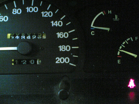

Ndi Posted October 18, 2005 Share Posted October 18, 2005 Ce, va consuma mult Cielo? Atunci dati-mi si mie un sfat Nota: Imaginea atasata nu este trucata, cu contoarul resetat, plinul facut pe jumatate, etc. What you see is what you get. Link to comment

Tommy Posted October 18, 2005 Share Posted October 18, 2005 (edited) NDI, n-am inteles exact cat ti-a consumat .. chestia e ca doar de la MOL pun si eu benzina, si o arde nu gluma, pun si 95 si 98 (una una) cu petrom a consumat ceva mai putin intr-adevar nu cred sa aiba ceva pe la bujii sau altele.. ca motorul merge perfect rotund si nu face nici o figura a mai patit careva la fel cu benzina de la mol? si inca o intrebare as avea, la euro2 16v, care benzina e mai buna.. 95 sau 98? Edited October 18, 2005 by Tommy Link to comment

Ndi Posted October 18, 2005 Share Posted October 18, 2005 Tommy: Se vede acul de benzina si numarul de kilometri de la ultimul plin (120). Vlad: Nu cred ca e sonda stricata Link to comment
Tommy Posted October 18, 2005 Share Posted October 18, 2005 (edited) ma rog, e acul tau zi-i frate consumul ca doar nu te doare burta la mine .. ultimul la oras 14.7 si uite de ce n-am inteles: citat: Nota: Imaginea atasata nu este trucata, cu contoarul resetat, plinul facut pe jumatate, etc. What you see is what you get. am crezut ca erai la jumate... dar daca era plin.. am inteles (30/120)*100=25 Edited October 18, 2005 by Tommy Link to comment
