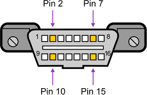

Razor Posted November 14, 2005 Share Posted November 14, 2005 (edited) Pentru a clarifica odata pentru totdeauna treaba cu standardele in discutie: PWM Conectorul are pini: 2, 4, 5, 10, si 16 VPW Conectorul are pini 2, 4, 5, si 16, dar nu are 10. ISO Conectorul are pini 4, 5, 7, si 16. Pinul 15 poate sau nu sa fie. Edited November 14, 2005 by Razor Link to comment
