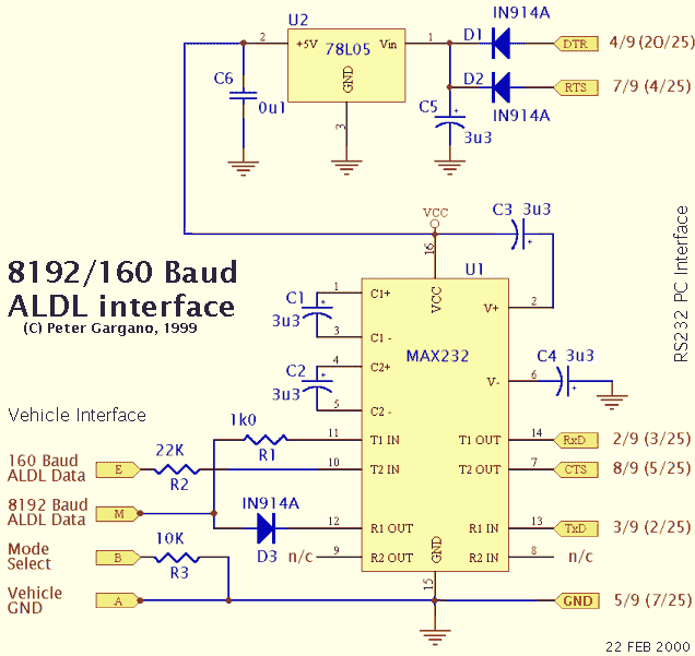

caimanok7 Posted January 6, 2007 Share Posted January 6, 2007 tyranus said: Iata si primele screen shoot-uri ale "creatiei" mele.Functioneaza comunicatia,simulat, intre doua calculatoare cu o interfata cu Max RS232. Are cineva un DS275 ?(e schivalent cu max-ul dar nu are condensatoare). A rasarit soarele si pe ulita noastra... Produsul final va functiona atat pe LCD (pt driver-ul masinii) cat si pe RS232/USB pt diagnoza completa, dar... totus se va reduce la pretul final al intregului subansamblu. Nici nu stiu ce sa folosesc mai bine : un LCD alfanumeric sau unul dot-matrix? Ce sugerati? HI,I am Italian, I have one matiz 800cc (year 2002), than interface and which soft. I must use in order to be connected with the PC? where you have found this program interesting? Thanks. Link to comment

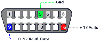

caimanok7 Posted January 7, 2007 Share Posted January 7, 2007 (edited) I can connect to pin 9 (obd2 connector) an interface with rs232 and using myaldl? Edited January 8, 2007 by tolin Link to comment
ovi_jer Posted January 7, 2007 Share Posted January 7, 2007 mr_ : http://www.gmclub.ro/forum/index.php?s=&am...st&p=164863 caimanok7@ No. Matiz 2002 in Italy - euro 3- OBD2 protocol KWP 2000. You need interface OBD2 with ELM 327 with software compatible. Link to comment
caimanok7 Posted January 8, 2007 Share Posted January 8, 2007 my car is euro 4 and in the connector odb2 is present pin 4-7-9-12 and 16 Link to comment
caimanok7 Posted January 8, 2007 Share Posted January 8, 2007 ovi_jer said: Is the same interface . myaldl can work with this interface? Link to comment
ovi_jer Posted January 8, 2007 Share Posted January 8, 2007 Yes but only daewoo nexia,espero,nubira 1,leganza. You need interface OBD2 with ELM 327 with software compatible. Link to comment
caimanok7 Posted January 8, 2007 Share Posted January 8, 2007 why in menu select model of myaldl (ver2.3) i can select : Matiz - obdII ? Link to comment
ovi_jer Posted January 8, 2007 Share Posted January 8, 2007 Because the one that made the software thought he will get the software working on Matiz but didn't make it. Link to comment

ovi_jer Posted February 14, 2007 Share Posted February 14, 2007 Pentru a citii parametrii ai nevoie decit de 4-5,7 si 16. Ce treaba ai cu pinul 12? Link to comment
jake Posted February 14, 2007 Share Posted February 14, 2007 Baroane, ai reusit sa citesti ceva numai pe linia K ? Zi da sau nu, nu-ti cer amanunte, doar sa stiu sa nu muncesc aiurea. Link to comment
tolin Posted February 14, 2007 Share Posted February 14, 2007 Daca-i vorba de motorul tau, da. ECM-ul raspunde unui protocol EOBD (KWP2000). Link to comment
