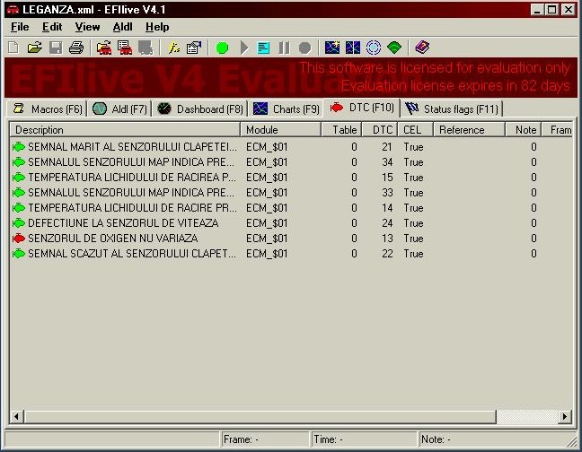

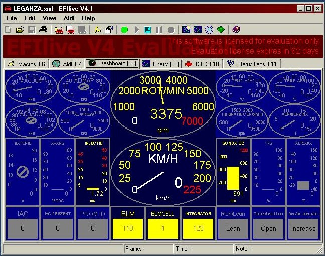

mr_ Posted January 11, 2012 Share Posted January 11, 2012 Merge, eu am avut asa-zis nubira 2 care in realitate nu e decat un facelift, si mi-a mers interfata aia artizanala si cu daewoo.exe si cu efilive V4. Link to comment
mr_ Posted January 11, 2012 Share Posted January 11, 2012 Da, ma refer la o interfata artizanala facuta dupa schema de aici: http://www.gmclub.ro/forum/index.php?/topic/388-conectare-ecm/page__view__findpost__p__42457 Am pe undeva si niste printscreenuri cu cele doua softuri (daewoo.exe si efilive V4), daca le gasesc le pun. Link to comment

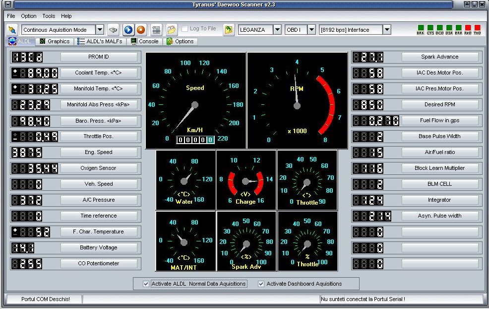

tester5 Posted February 8, 2012 Share Posted February 8, 2012 am incercat interfata si in program (MyALDL.exe)imi scrie ca portul com nu comunica cu interfata mentionez ca masina este nubira din 99 1.6 16v conector cu 12 pini Link to comment
mr_ Posted February 10, 2012 Share Posted February 10, 2012 Din cei 12 pini doar 3 sunt utilizati: alimentare, masa si comunicare. sigur i-ai bagat unde trebuie? Mie mi-a mers si cu scannerul lui Tyrannosaur si cu efilive V4 Link to comment
adrian_r5 Posted February 11, 2012 Share Posted February 11, 2012 Tyranus' Daewoo Scanner stie si OBD II ??? Link to comment
tester5 Posted February 11, 2012 Share Posted February 11, 2012 mr_ tot respectul aveati dreptate ,functioneaza si inca foarte bine .Problema mea (de care nu stiam)era hdd de 5g care era cu un picior in groapa ...astazi am imprumutat un alt laptop si intradevar atat schema cat si programul sunt perfecte .Va multumesc pentru raspunsurile prompte Link to comment
