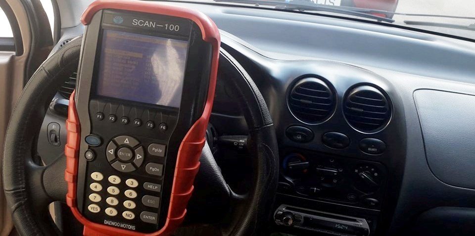

buburuza vesela Posted August 28, 2019 Share Posted August 28, 2019 Intre timp am facut rost de "jucaria" OEM de la Daewoo 😎 Link to comment
