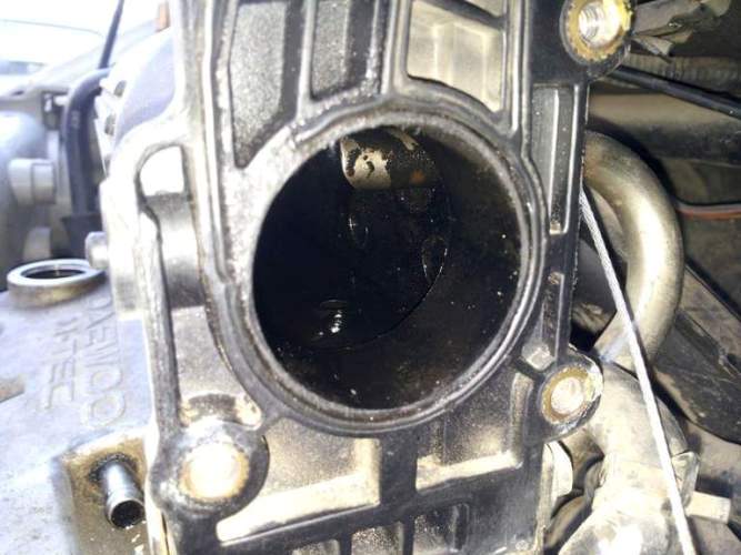

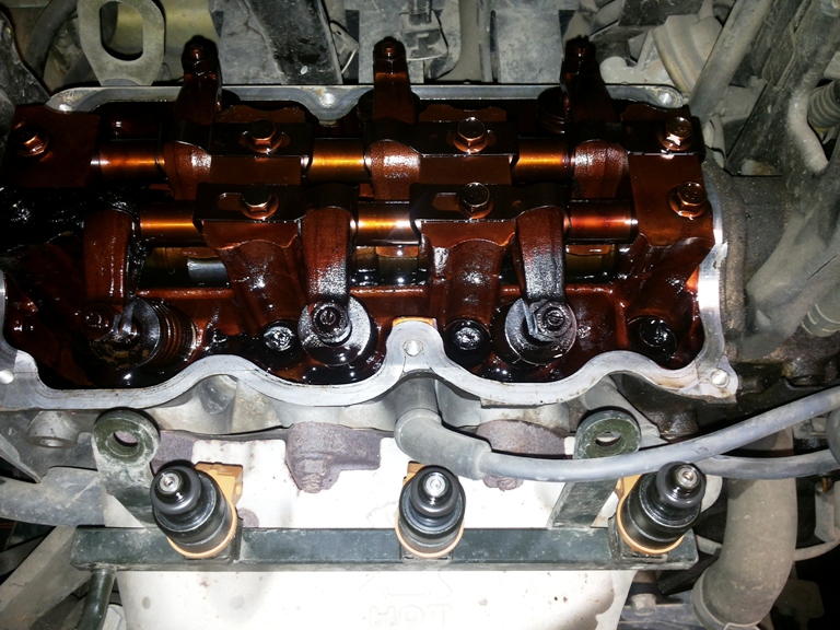

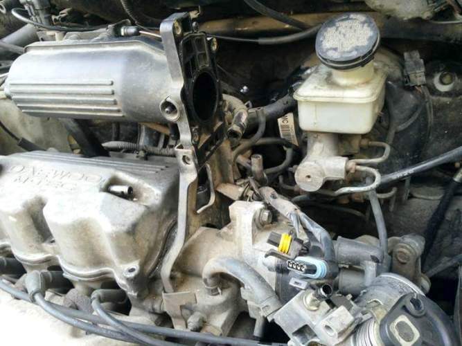

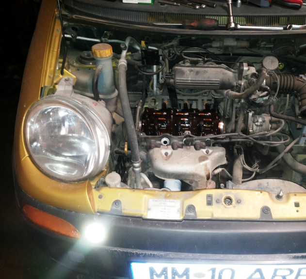

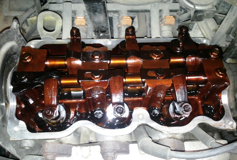

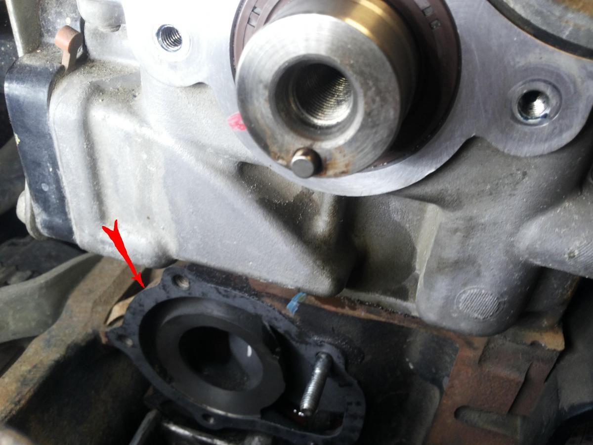

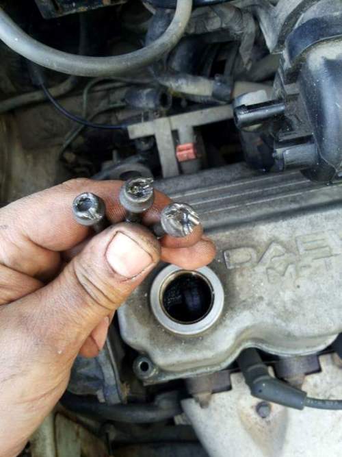

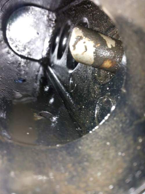

buburuza vesela Posted May 23, 2016 Author Share Posted May 23, 2016 (edited) George din Colentina 21.05.2016 Din seria: Sa facem imposibilul, posibil Fara a demonta galeria de admisie, trebuiesc desfacute cele 3 suruburi de pe spatele capacului culbutorilor. Mentiune: Suruburile au fost rotunjite cu un imbus inadecvat de catre un nene "mecanic" intr-un service cu pretentii. Edited May 23, 2016 by buburuza vesela 1 Link to comment
ches Posted May 23, 2016 Share Posted May 23, 2016 Motorul ala arata ca in filmele de groaza 1 Link to comment
buburuza vesela Posted May 23, 2016 Author Share Posted May 23, 2016 (edited) Aparent parea ok, dar a trebuit resuscitat serios. A trebuit sa trec de suruburile alea sa ajung la culbutori (acolo aveam interes..) Edited May 23, 2016 by buburuza vesela Link to comment

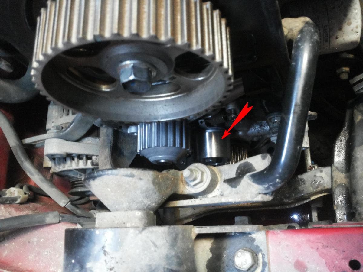

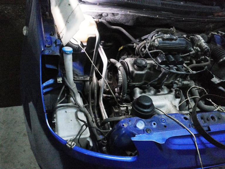

buburuza vesela Posted May 25, 2016 Author Share Posted May 25, 2016 (edited) Marian - Vacaresti 24.05.2016 Sparky pe masa de operatie ... Distributie & pompa apa. Edited May 25, 2016 by buburuza vesela Link to comment

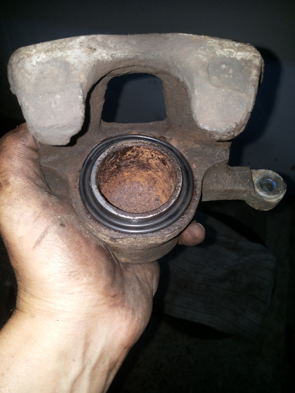

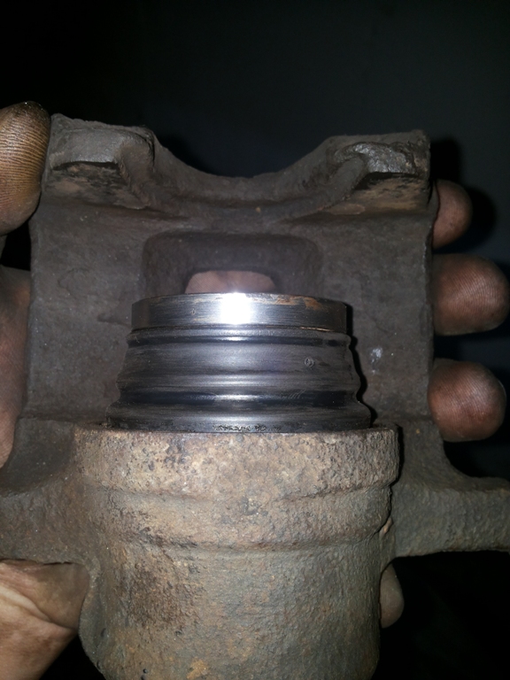

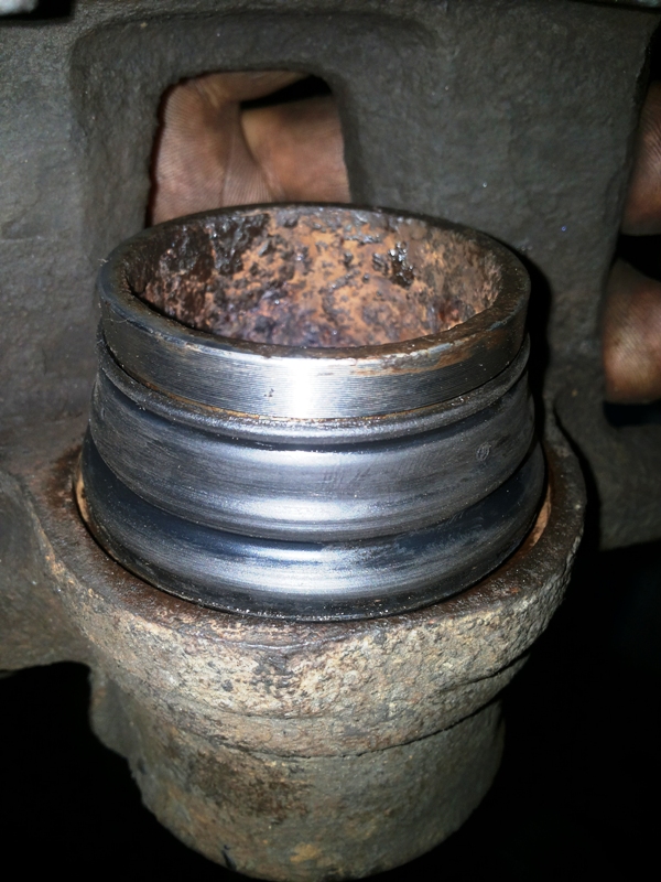

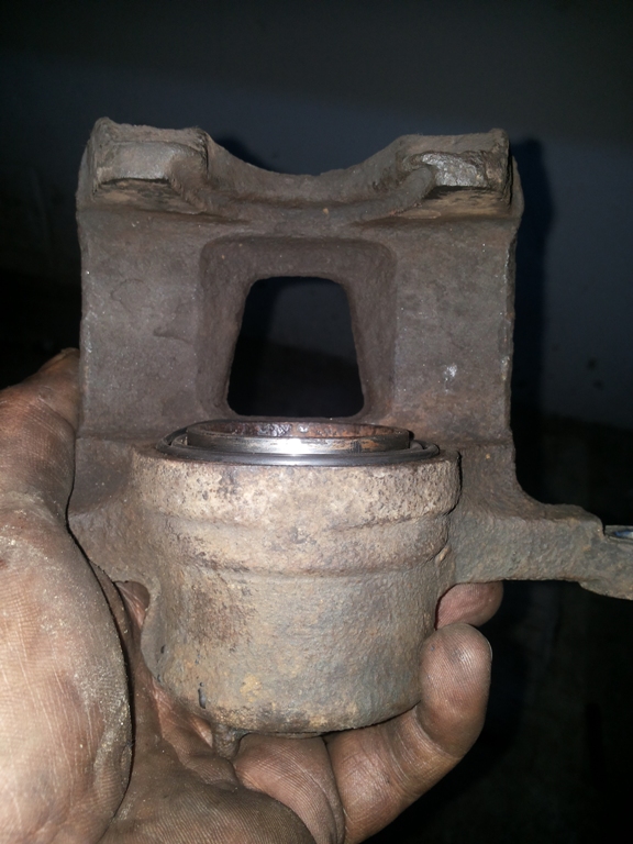

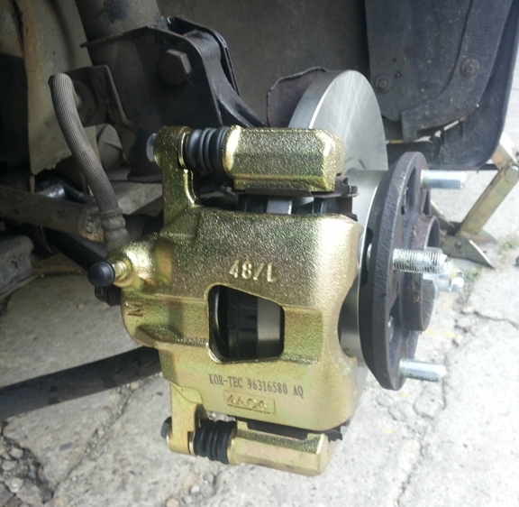

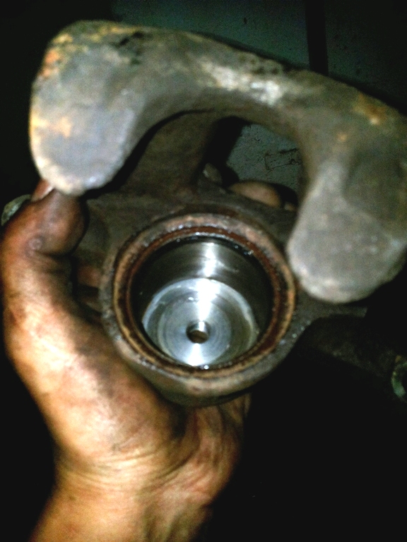

buburuza vesela Posted May 26, 2016 Author Share Posted May 26, 2016 (edited) Cristian, Buc - Valea Ialomitei 25.05.2016 Inlocuire garnituri etrieri. Cauza: Garnitura antipraf desprinsa din corp etrier, rugina pe pistonul de frana, blocare piston pe placuta, roata supraincalzita & franare ineficienta. S-a putut folosi in continuare pistonul de frana, nu era atacata suprafata acestuia de rugina. Edited May 26, 2016 by buburuza vesela 1 Link to comment

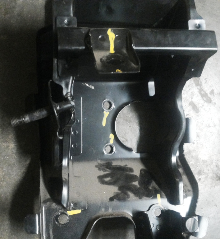

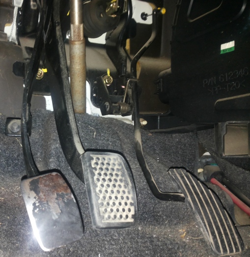

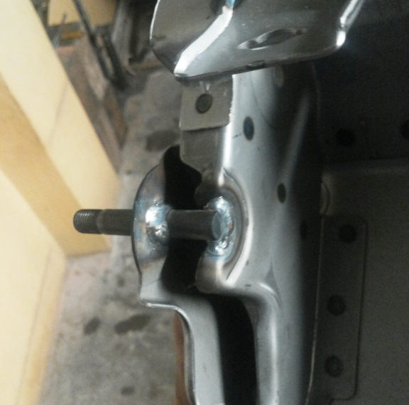

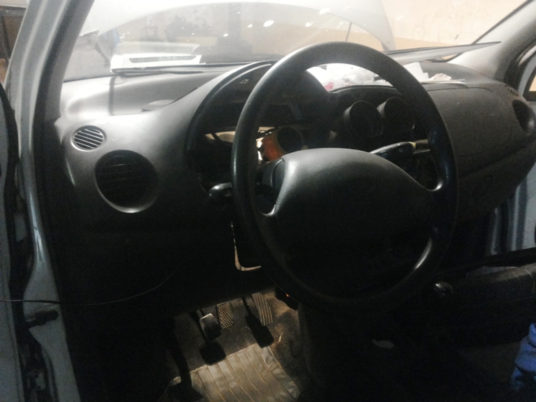

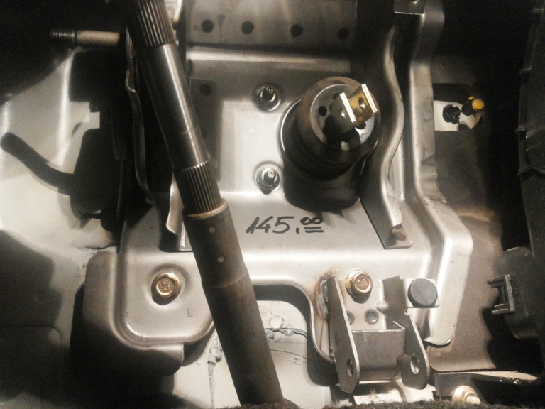

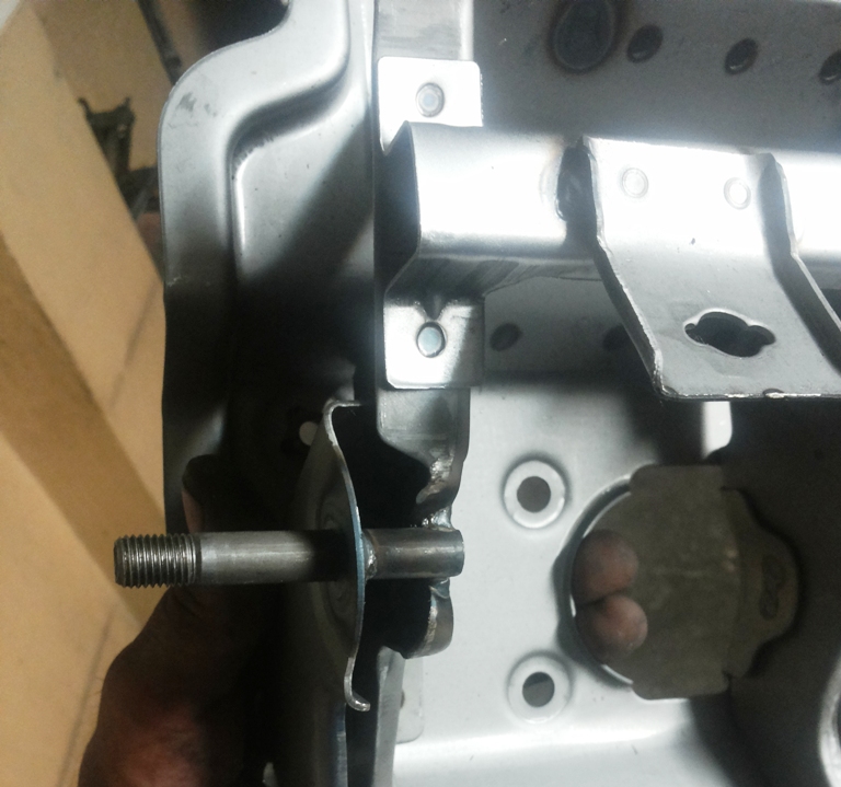

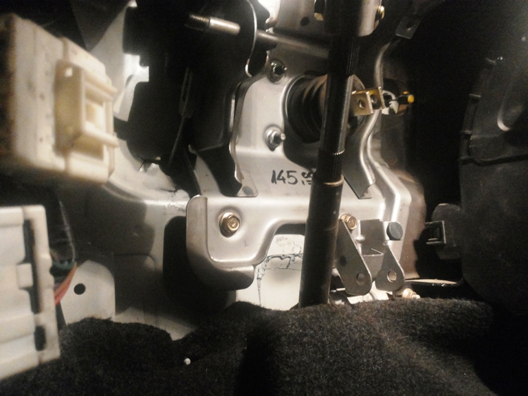

buburuza vesela Posted August 18, 2016 Author Share Posted August 18, 2016 (edited) Dragos ( livrari food) 17.08.2016 Debreiem sau franam ... * Inlocuire suport pedalier* Pozele spun tot > Daca nu ati mai facut asta vreodata, nu stati bine cu nervii iar rabdarea va lipseste cu desavarsire...nu incercati asta acasaDe obicei asa ceva se inlocuieste cu bordul (tot) dat jos si implicit coloana volanului, marind astfel timpul de lucru... Edited August 18, 2016 by buburuza vesela Link to comment

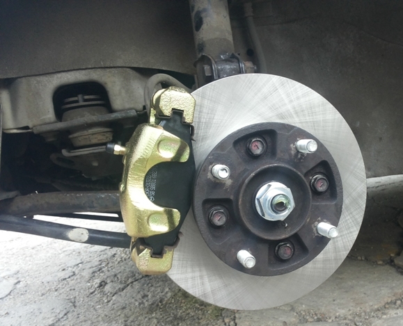

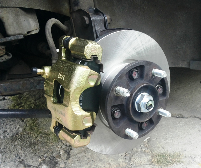

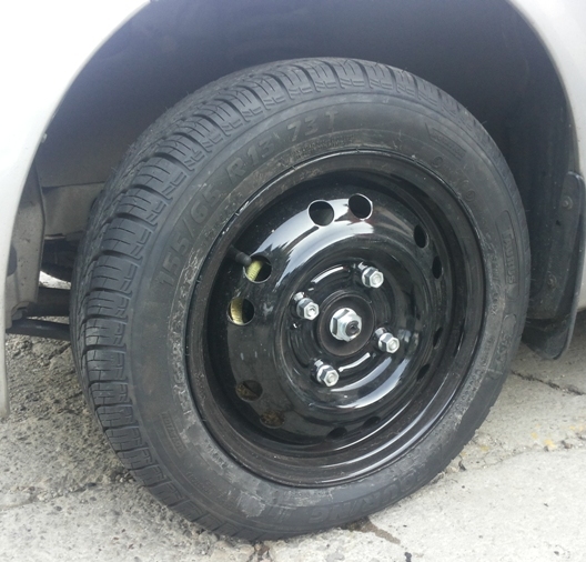

buburuza vesela Posted August 26, 2016 Author Share Posted August 26, 2016 (edited) Xiandevil (user MatizClub.ro) 25.08.2016Sau inlocuit:*Rulmentii rotilor fata.*Prezoane (ambele roti)*Ansamblul etrier frana(ambele roti).*Discurile de frana*Placute frana*Aerisire frana Edited August 26, 2016 by buburuza vesela Link to comment

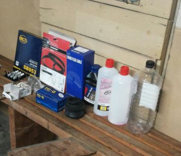

buburuza vesela Posted September 26, 2016 Author Share Posted September 26, 2016 (edited) Revizii de toamna 2016. Cateva foto: Edited September 26, 2016 by buburuza vesela Link to comment
Viktor Posted September 27, 2016 Share Posted September 27, 2016 Asa rau se scumpi vaselina, buburuza ? De regula, culisantele placutelor se greseaza cu un strat subtire, din trei motive : 1) - asigura o culisare excelenta. 2) - tine rugina la respect (anti rugina). 3) - iti pregatesti terenul pentru o urmatoare interventie etrierilor ( indepartarea cu usurinta a impuritatilor, altfel iti vine rau la curatat). Din nou, atit suprafata de contact a pistonului cu placuta, cit si "calaretul" in contact cu placuta , se greseaza, din aceleasi motiv , mentionat in punctul 3. E o idee doar ... Link to comment
buburuza vesela Posted September 27, 2016 Author Share Posted September 27, 2016 Nu stiu despre ce vorbesti si la ce faci referire Fi mai explicit... observ o oarecare ironie in tonul/textul tau. Ne cunoastem de undeva? Ai trecut pe la mine si te.a nemultumit ceva? Astept explicatii pentru afirmatiile pe care le faci pentru ca mai apoi sa beneficiezi si de replica. O zi buna. Link to comment
Viktor Posted September 27, 2016 Share Posted September 27, 2016 Nu fi bre asa suparacios, breee ... Nu fu decit un sfat si pe un ton prietenesc , referitor la postul #59 unde , pe etrieri noi ai montat tablele alea ruginite si negresate de nu ma inseala ochiul (de soacra) in plus, am mai adaugat citeva puncte ale unui etrier ce se cer gresate, nu-i obligatoriu, dar se prea practica. Altfel, dupa cum crezi, de ei de bine si pui in practica e ok, de nu, nu ... Link to comment
buburuza vesela Posted September 27, 2016 Author Share Posted September 27, 2016 (edited) 1. Pe etrierii noi sau montat acele table deoarece clientul a venit fara pe etrierii noi, au fost curatate si gresate cele vechi. 2. Ulterior sau inlocuit cu cele noi. 3. Au fost gresate si noile culise ( e la mintea cocosului..) 4. La mine vaselina nu e scumpa ( e din partea casei tot timpul) 5. Cum ai fi dorit sa reactionez la astfel de post?( al tau) 6. Am depasit demult stadiul de a mi.se oferi sfaturi pe aceste teme... acum, dau. 7. Nu sunt suparacios... dar imi rezerv dreptul de a fi suspicios in privinta integritatii mentale a fiecaruia. O zi buna. Edited September 27, 2016 by buburuza vesela 3 Link to comment

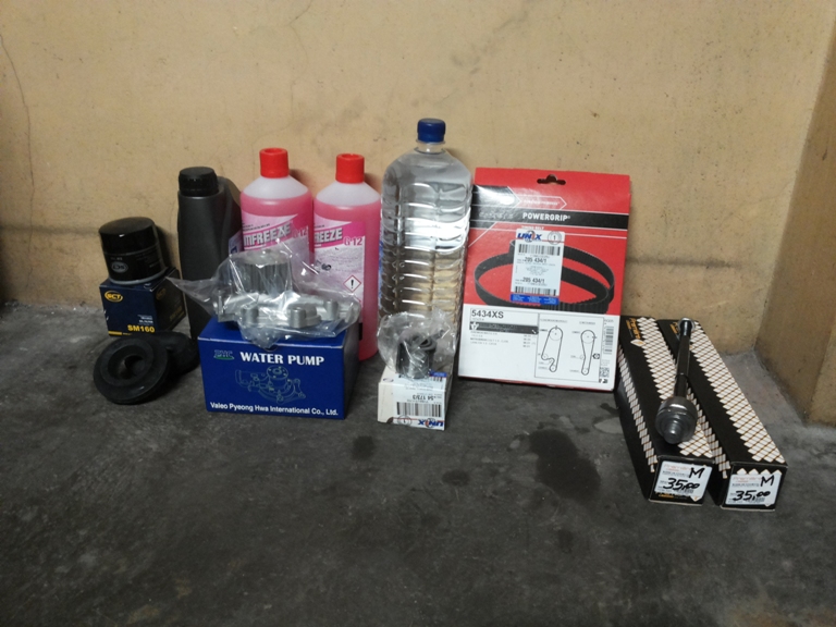

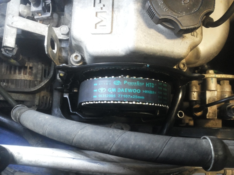

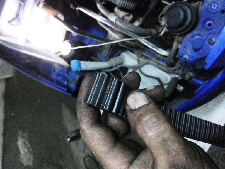

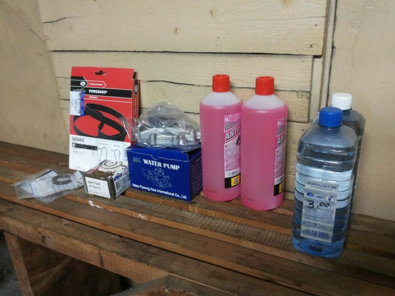

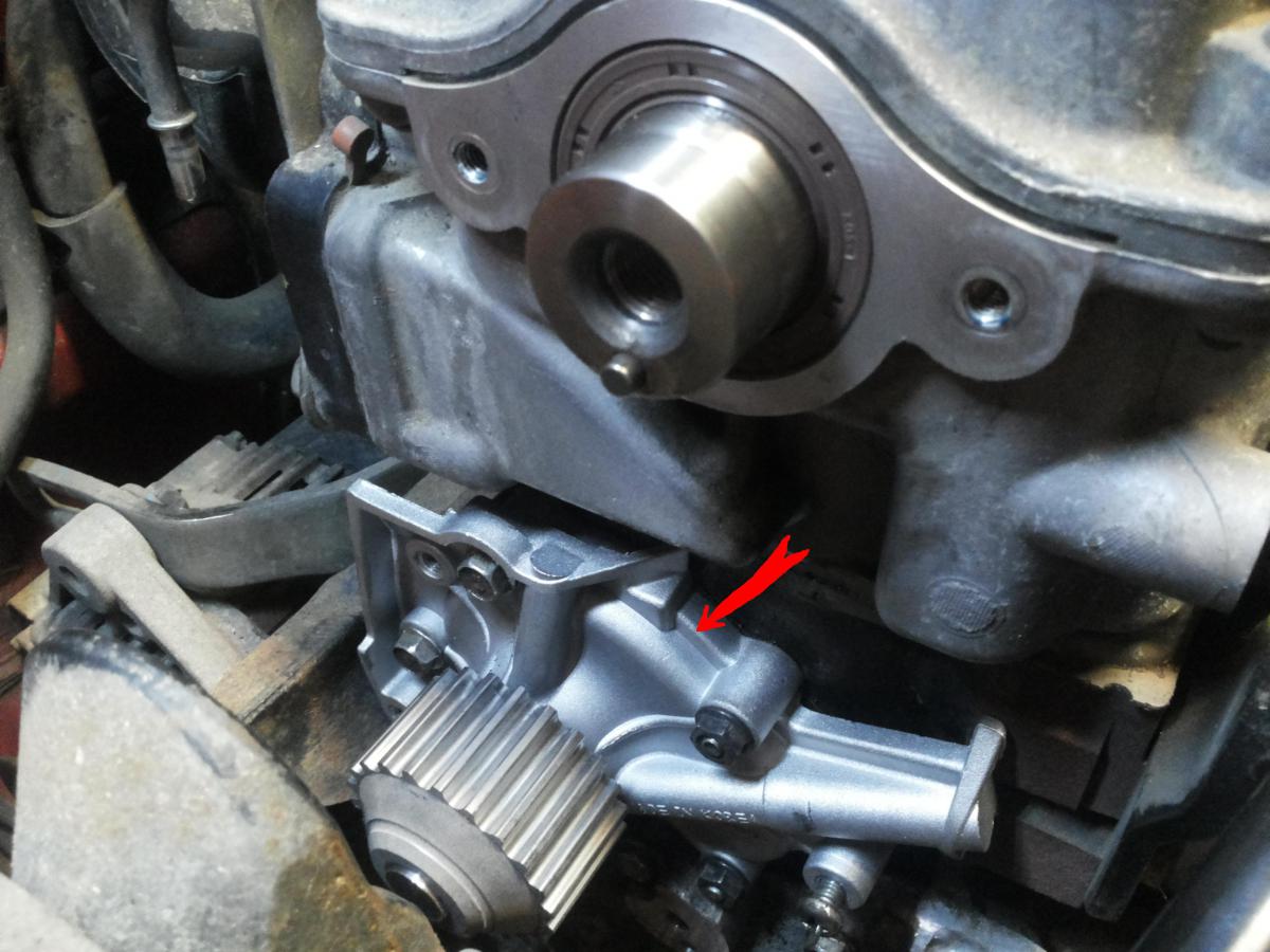

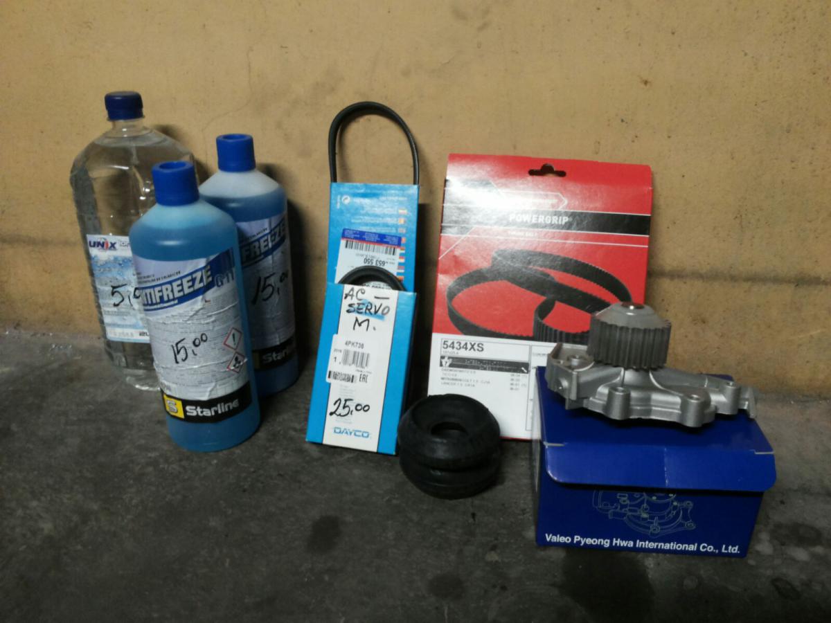

buburuza vesela Posted October 29, 2016 Author Share Posted October 29, 2016 (edited) 28.10.2016 ( Cristi - Aviatiei)Inlocuire kit distributie(pompa apa & simeringuri distributie).Pentru ca nu ai stat langa mine la montaj iti pun cateva foto din timpul operatiei.Drumuri bune. Edited October 29, 2016 by buburuza vesela Link to comment

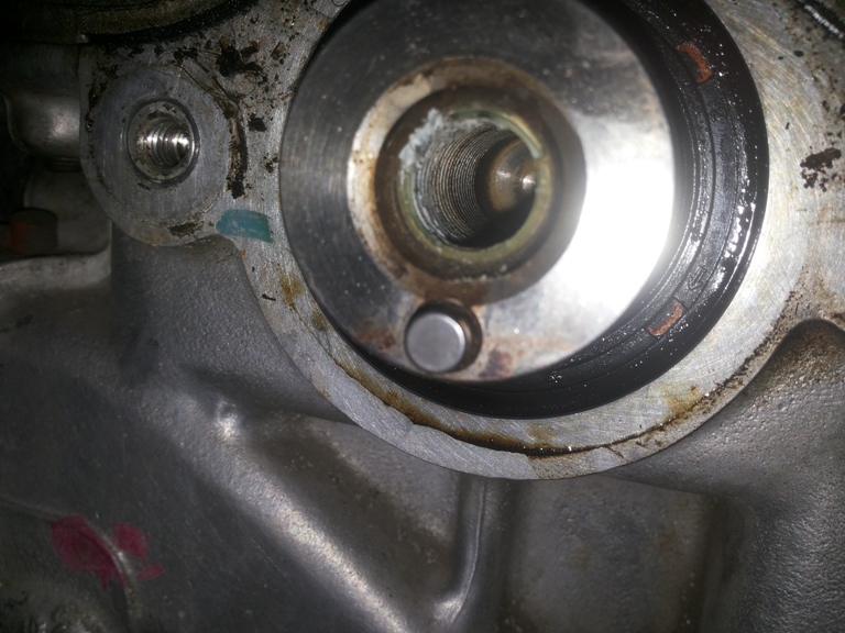

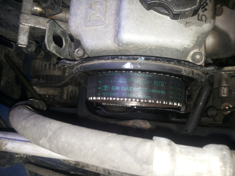

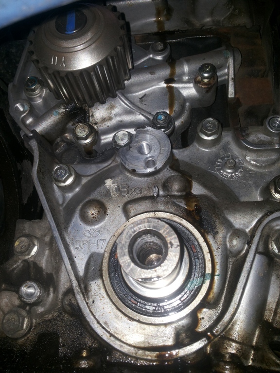

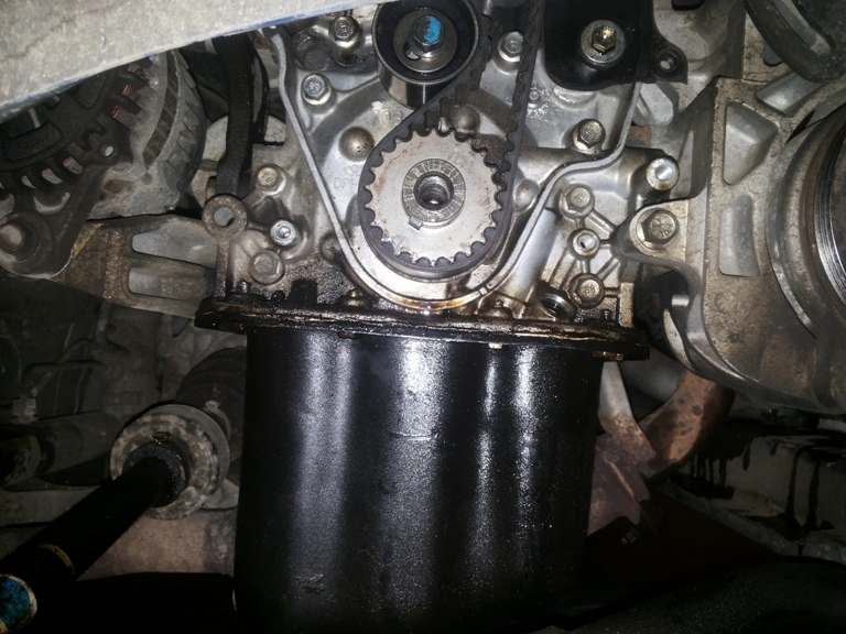

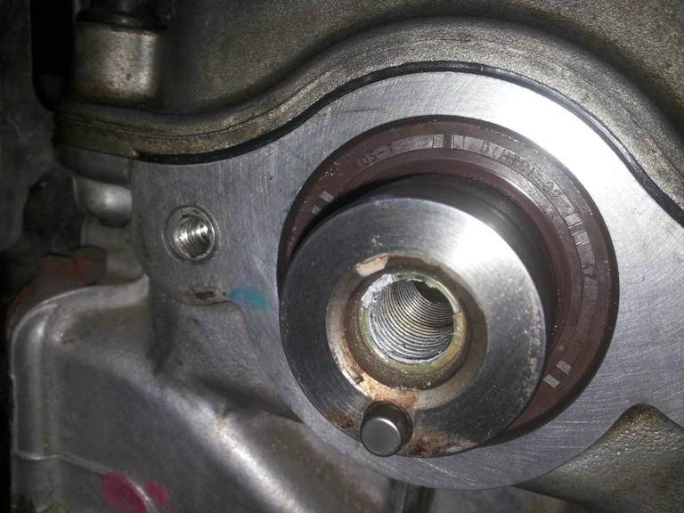

buburuza vesela Posted December 5, 2016 Author Share Posted December 5, 2016 (edited) 05.12.2016 Mihai(Pantelimon) Chevrolet Spark cutie automata. Inlocuire distributie (curea si rola) + simeringuri (axa came) & (arbore cotit)* Pe la cele doua simeringuri se pierdea foarte mult ulei datorita deteriorarii acestora.Recomand inlocuirea celor doua simeringuri la fiecare schimb al distributiei.* Inlocuire termostat.Pozele deoarece nu ai stat langa mine .. Edited December 5, 2016 by buburuza vesela Link to comment

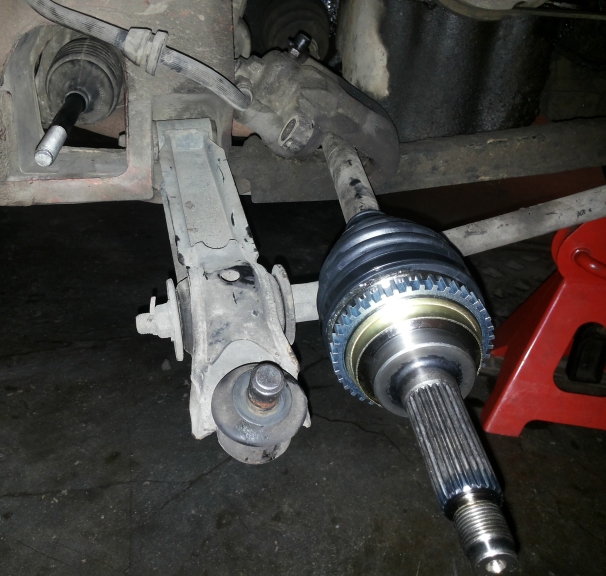

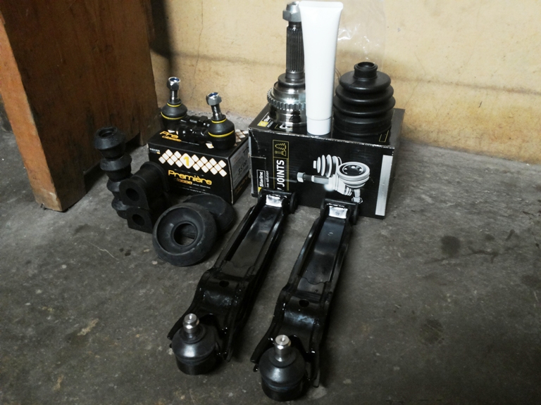

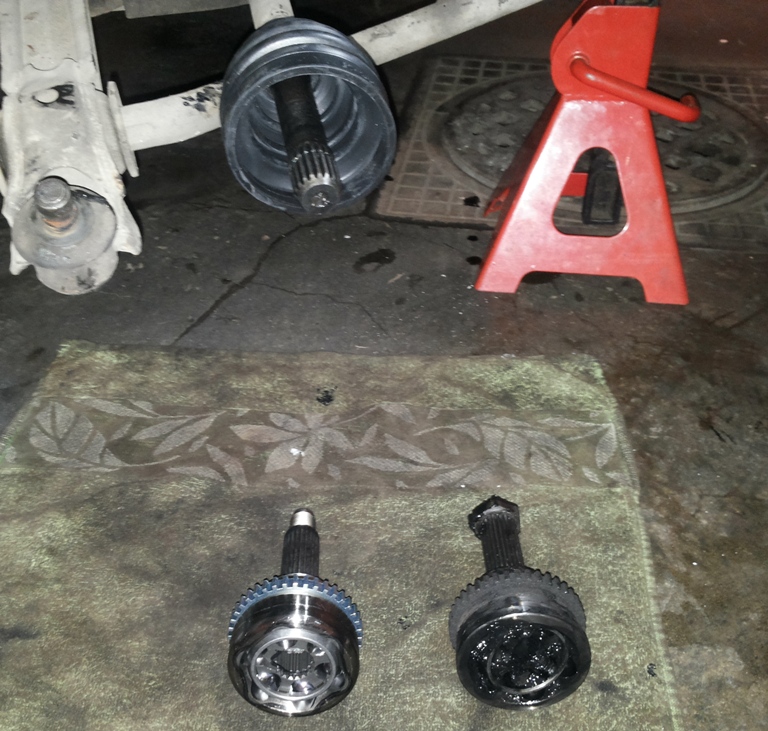

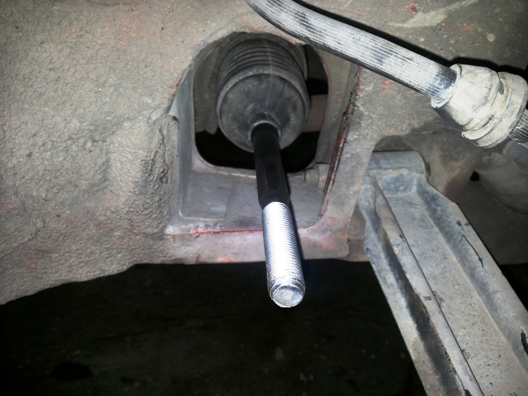

buburuza vesela Posted December 12, 2016 Author Share Posted December 12, 2016 (edited) 09.12.2016Florin (Colentina)*Inlocuire bielete directie*Inlocuire capete planetara*Inlocuire capete bara*Inlocuire bucsa caseta directie Edited December 12, 2016 by buburuza vesela Link to comment

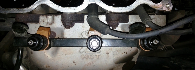

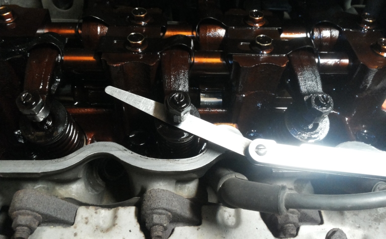

buburuza vesela Posted December 13, 2016 Author Share Posted December 13, 2016 (edited) 10.12.2016Ovidiu (Cluj)*Curatare injectoare*Reglaj culbutori(combinatia ideala pentru consum mic.. )Recomand din 40 in 40mii aceste doua operatii Edited December 13, 2016 by buburuza vesela Link to comment
buburuza vesela Posted December 21, 2016 Author Share Posted December 21, 2016 (edited) A venit Mosu' la CTS-u ... CTS-u a mai primit flanse noi (amortizoare) si o verificare (etrieri/placute/gresat culise/pistoane frana). Edited December 21, 2016 by buburuza vesela Link to comment
