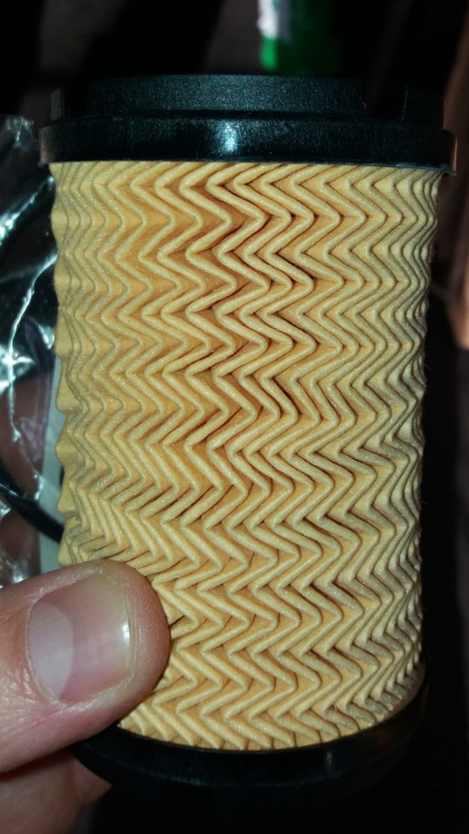

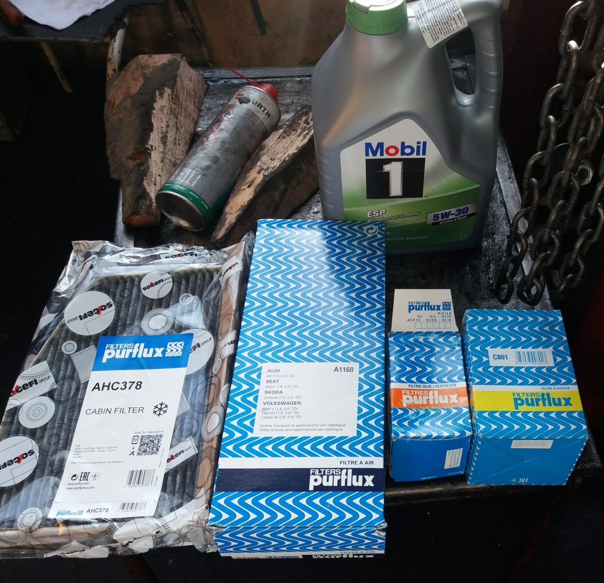

varais Posted January 27, 2020 Author Share Posted January 27, 2020 198 000 km Scimb de ulei Mobil 5w30 Set filtre Purflux. Este singurul filtru care are aproape duble suprafata filtranta. 2 Link to comment
ches Posted January 27, 2020 Share Posted January 27, 2020 Am auzit si eu numai de bine despre filtrele de ulei Purflux, insa pana acum nu le-am incercat. Poate la urmatorul schimb daca s-or face si pt Captiva 🙂 . Link to comment

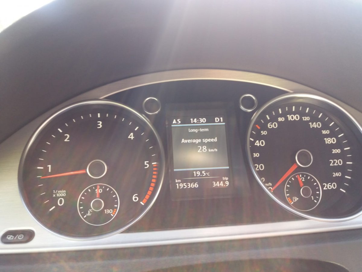

varais Posted April 16, 2020 Author Share Posted April 16, 2020 Se pare ca ii prieste carantina. Exclusiv Bucuresti. Link to comment
Akon Posted April 20, 2020 Share Posted April 20, 2020 Ai bagat ceva rulaj cu spatele daca in ianuarie avea 198 si acum are 195 :)) 1 1 Link to comment
varais Posted April 21, 2020 Author Share Posted April 21, 2020 13 hours ago, Akon said: Ai bagat ceva rulaj cu spatele daca in ianuarie avea 198 si acum are 195 :)) @Akon Cand imbatranesti si scrii din memorie se intampla si astfel de lucruri ! 1 1 Link to comment

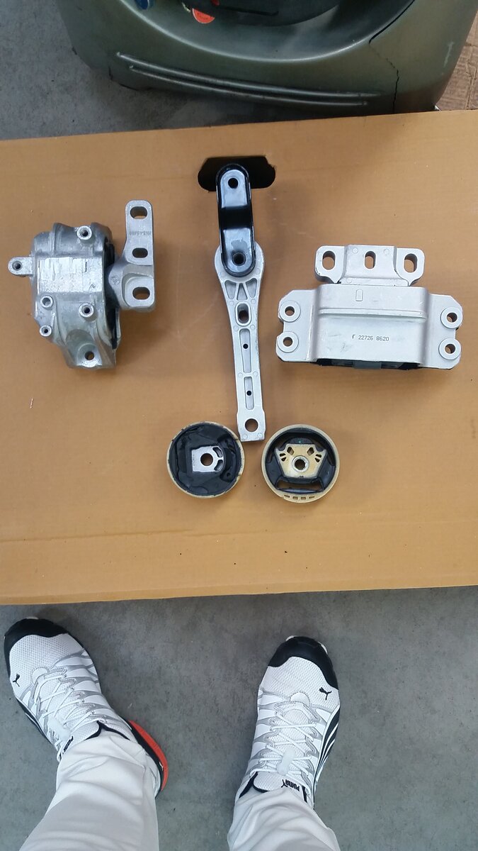

varais Posted May 14, 2022 Author Share Posted May 14, 2022 224500 km. Schimbat tot ce inseamna suport de motor. Incepuse sa aiba un mic balans fata spate mai ales la rece. Asa ca... 2 Link to comment
pompiliu92 Posted May 15, 2022 Share Posted May 15, 2022 Ala rotund de la cutie cum s-a procedat cu schimbarea lui? Am vazut ca unii au o scula speciala. Link to comment
varais Posted May 16, 2022 Author Share Posted May 16, 2022 @pompiliu92 ala a fost cel mai greu de rezolvat. Dat jos subsasiul cu tot cu bascule, bucsele sparte pt ca au marginea din textolit ceva si bagate cu presa hidraulica. Link to comment
