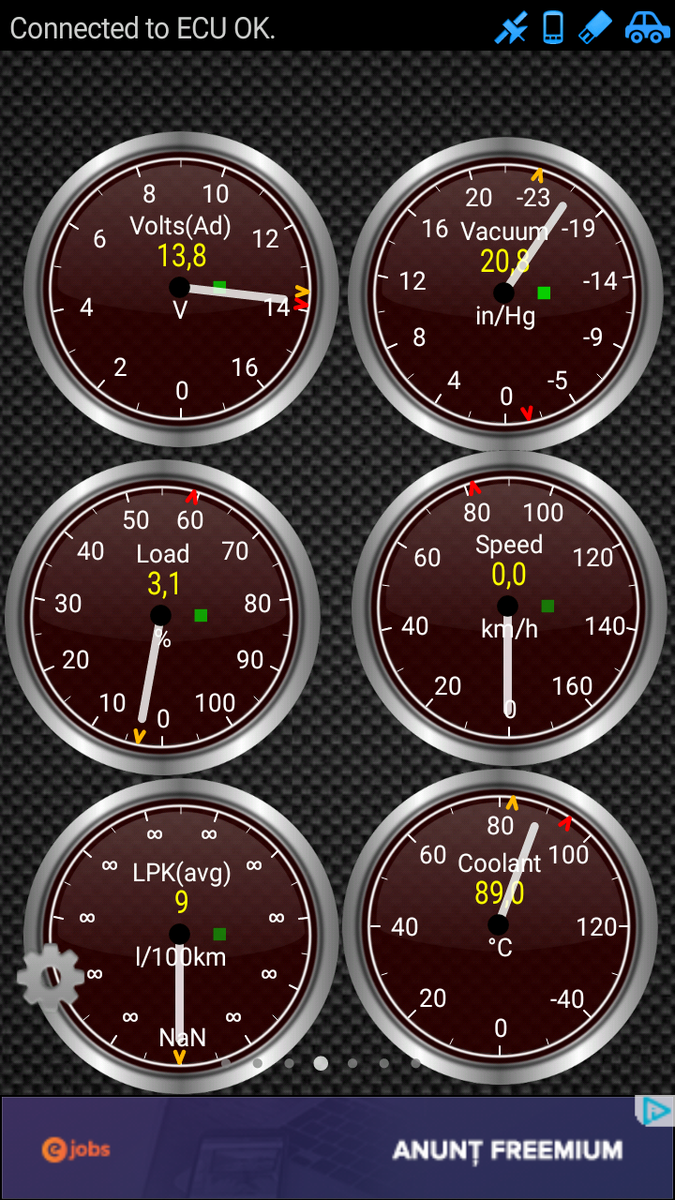

nt98adu Posted June 18, 2018 Author Share Posted June 18, 2018 Totodata, am achizitionat o interfata bluethooth ce afiseaza parametri drept urmare ma bate gandul la o navigatie android care sa comunice cu interfata. Chiar daca sunt mai old scholl, chestia asta, imi place.😋 Link to comment

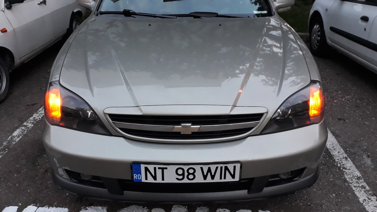

nt98adu Posted July 5, 2018 Author Share Posted July 5, 2018 Schimbare de look si US style cum ii sta bine unui Chevrolet😀 2 Link to comment

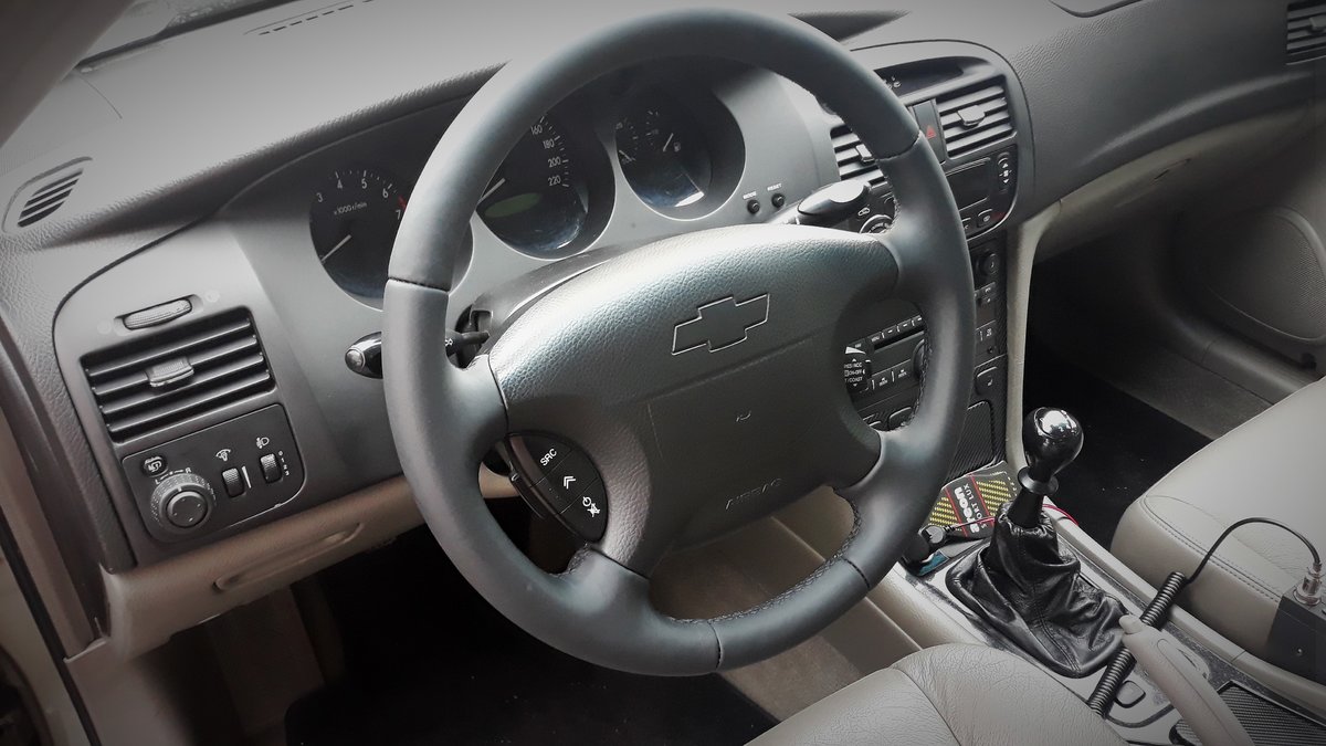

nt98adu Posted July 9, 2018 Author Share Posted July 9, 2018 Rulat 250 km in weekend cu un consum de 7% GPL. Super multumit de masinuta asta🙂 Drept urmare, i-am reinbracat volanul in piele din cauza unor zgarieturi pronuntate. Link to comment
