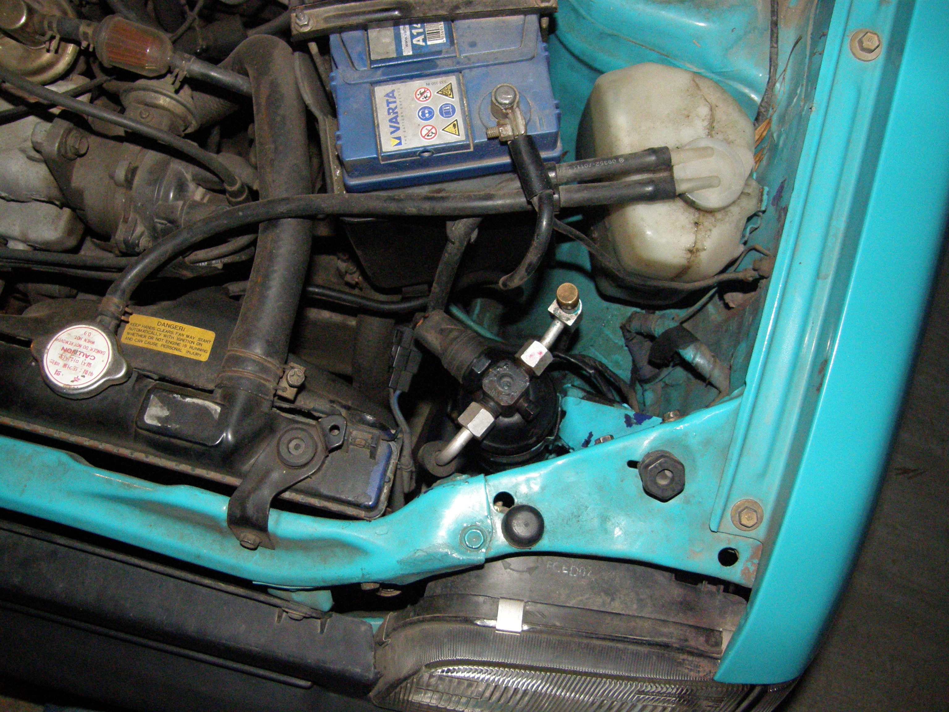

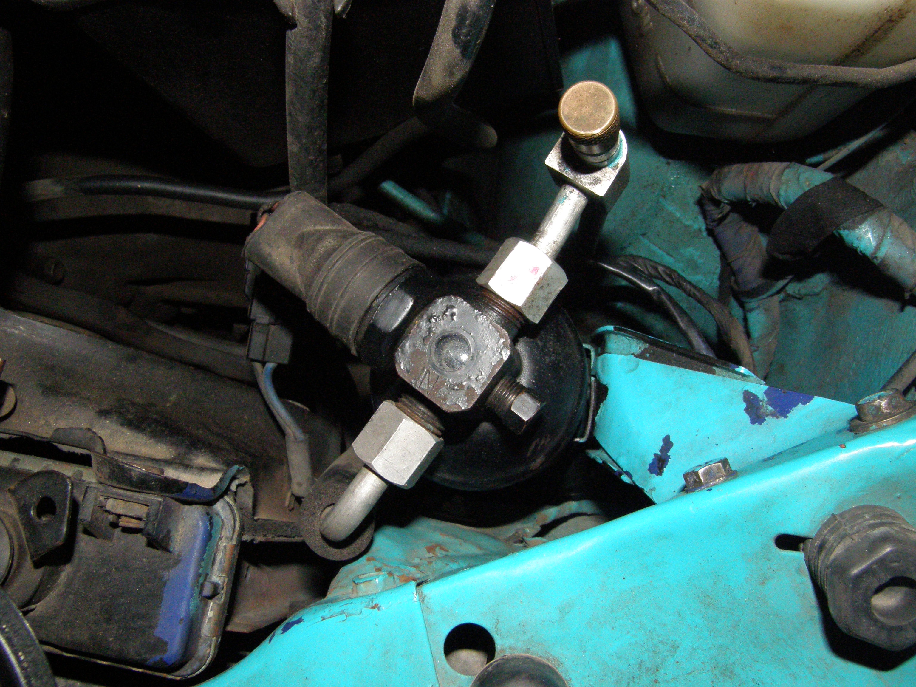

manole79 Posted April 5, 2009 Share Posted April 5, 2009 CatalinC said: sa dea naiba daca vad vrun gemulet Ok, postez niste poze cu "butelia" instalatiei de AC (mentionez ca initial instalatia a fost conceputa pentru agent refrigerant R12). Link to comment
Tetea Posted April 6, 2009 Share Posted April 6, 2009 (edited) Gemuletul ala e in locul indicat in poza. Poza e mai veche si butelia AC de acolo era cea originala si nu avea geam. Intre timp am schimbat-o si aia noua are. L.E. A, dupa aia am observat ca a mai pus cineva poze. Edited April 6, 2009 by Tetea Link to comment
iuliu m. Posted April 6, 2009 Share Posted April 6, 2009 De curiozitate m-am uitat si eu azi la butelia de AC.Nu are geam de vizitare si "cercetam" cam "adanc" la ea, de-au ras nishte colegi de mine... E interesant sistemul cu fereastra. Link to comment
CatalinC Posted April 7, 2009 Share Posted April 7, 2009 Deci eu nu am asa ceva. multumesc. Link to comment
