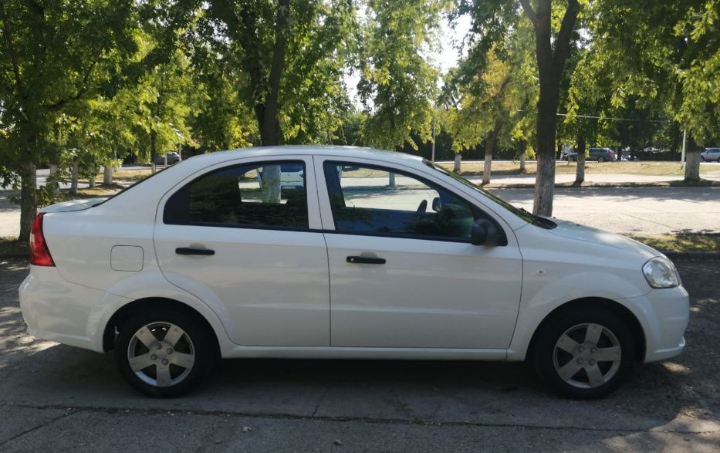

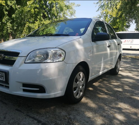

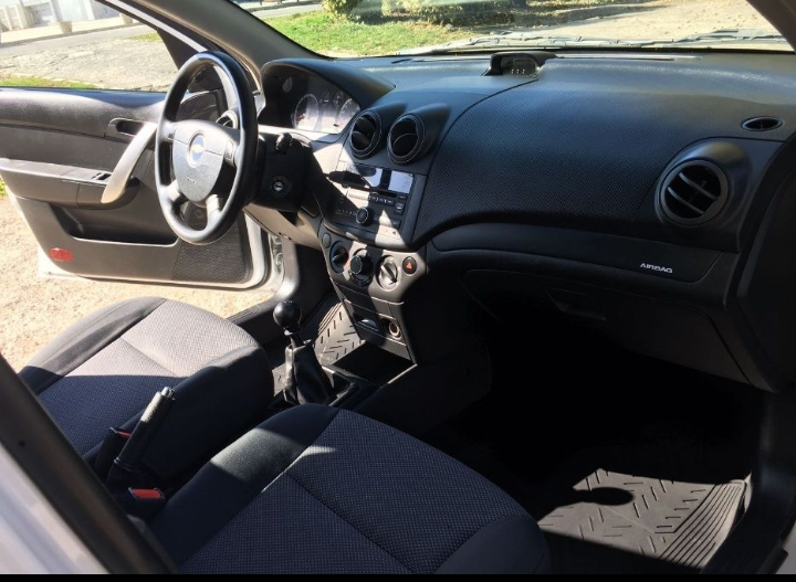

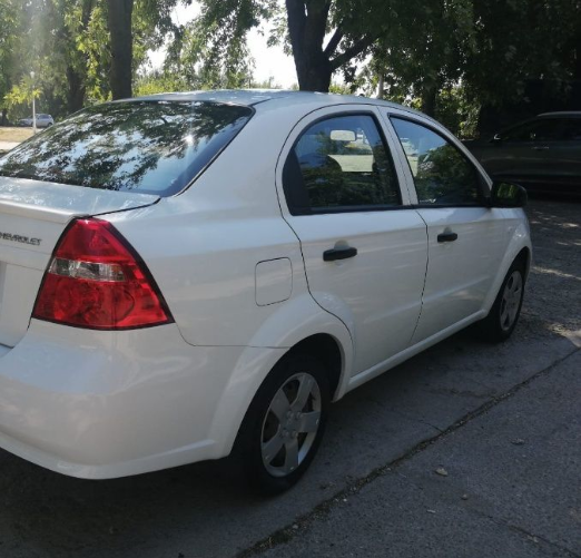

catapkz Posted December 6, 2019 Author Share Posted December 6, 2019 cateva crop-uri din anuntul masinii: Link to comment

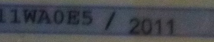

catapkz Posted December 6, 2019 Author Share Posted December 6, 2019 (edited) o precizare, dupa ce m-am uitat si in carte... prima înmatriculare e din 04.2012 dar e produsa in 2011 Nu ca ar conta prea mult... Edited December 6, 2019 by catapkz Link to comment
