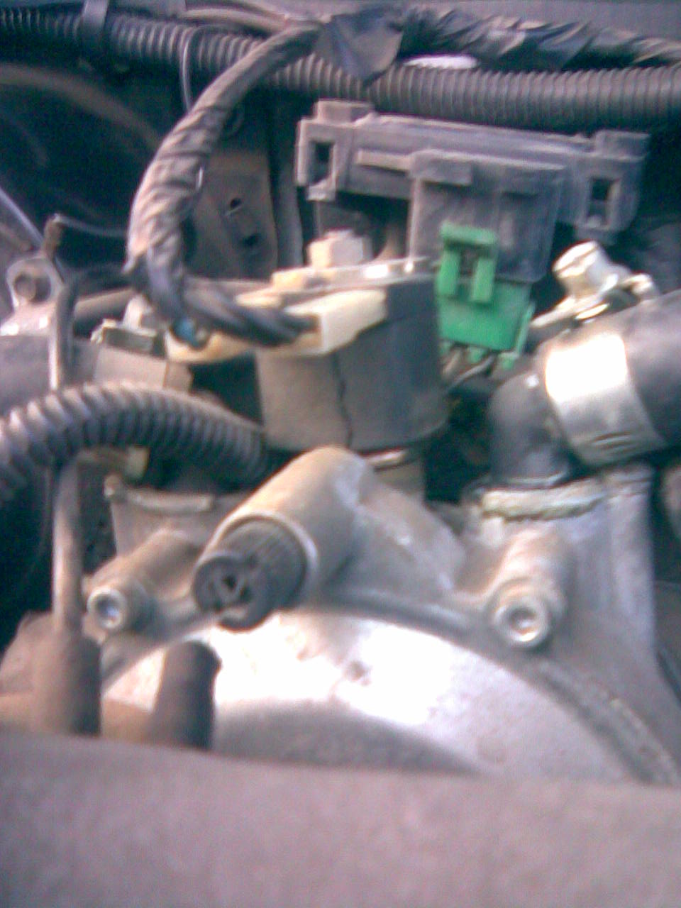

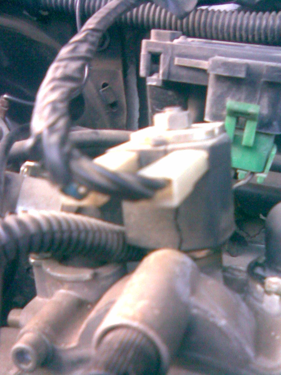

D K Z Posted October 26, 2007 Share Posted October 26, 2007 Salut. Am observat ca am o piesa ce pare a fi crapata si se afla deasupra ,,plamanului`` instalatiei de gaz.Care este rolul ei si cat dauneaza daca nu este inlocuita Link to comment
bella Posted October 26, 2007 Share Posted October 26, 2007 Este o electrovalava din cate imi dau seama. Eu nu as sta pe ganduri si as schimba-o. Link to comment
D K Z Posted October 26, 2007 Share Posted October 26, 2007 O adresa ceva de unde pot sa o cumpar sau un nr. de telefon? Link to comment
bella Posted October 26, 2007 Share Posted October 26, 2007 Incearca la www.agrom.ro Din experientele mele si ale altor cativa membrii fac treaba buna. Bafta. Link to comment
