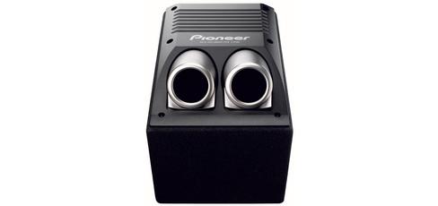

dinoc Posted July 28, 2005 Share Posted July 28, 2005 (edited) Infinty-ul ala (Basslink) este bass reflex sau nu - ca nu-mi dau seama ... Dar de subwooferul asta activ de la Pioneer ce credeti: http://www.pioneer-eur.com/eur/product_det...onomy_id=25-130 Altceva, folia Dynamat ce rol are ? Doar antifionare ? Poate inlocui folia de plastic din usa, cea care acopera gaurile din usa si protejeaza de apa/praf ? Edited July 28, 2005 by dinoc Link to comment
