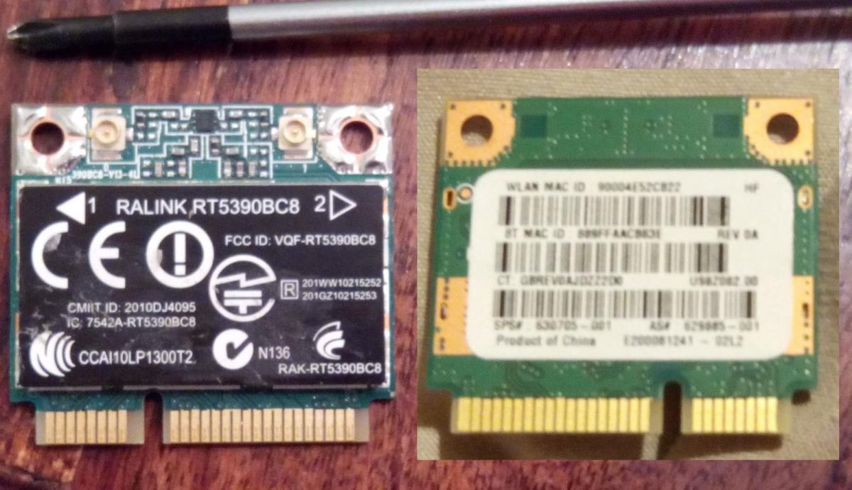

mr_ Posted December 16, 2013 Share Posted December 16, 2013 Am o intrebare. Am un laptop HP Pavilion DM1 crapat de vreo 3 ani vechime pe care il folosesc ca donator de organe. Intrebarea e, merge scoasa placa wifi (care stie N) si bagata intr-o vechitura de laptop lenovo vreo 6 ani care inca se tine bine, insa a carui placa wifi actuala stie doar G? Link to comment
VAXXi Posted December 16, 2013 Share Posted December 16, 2013 Daca e card cu interfata "de extensie" (PCMCIA, Express Card, d-astea) ai avea sanse. Fa rost de manualul de service (sau demonteaza-l direct) si vezi ce tip de placa e. Link to comment
mr_ Posted December 16, 2013 Share Posted December 16, 2013 Pai e una normala, interna. Nu e din aia externa care se baga pe pcmcia Uite-o Link to comment
VAXXi Posted December 16, 2013 Share Posted December 16, 2013 http://wikidevi.com/wiki/Ralink_RT5390BC8_Reference_Design Interface: Mini PCIe (half) Ti-ai raspuns la intrebare ? Link to comment
mr_ Posted December 16, 2013 Share Posted December 16, 2013 Da... daca intra fara sa folosesc ciocanul sau superglue inseamna ca merge Link to comment
Dj_Dark Posted December 17, 2013 Share Posted December 17, 2013 Mai mult ca sigur ala de 6 ani are "full" mini pci da' incearca Link to comment
