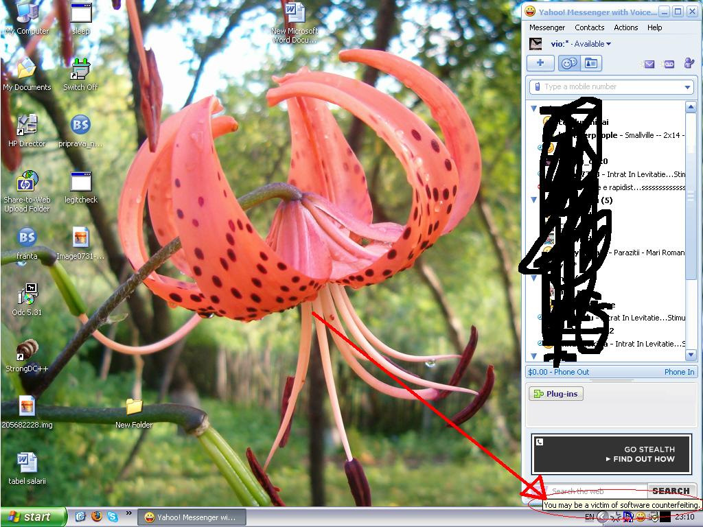

sorin77 Posted September 29, 2006 Share Posted September 29, 2006 (edited) i-a vedeti poza atasata Edited September 29, 2006 by sorin77 Link to comment
bogdan_o Posted October 5, 2006 Share Posted October 5, 2006 Ete dovada Iti mai apare un mesaj si cand pornesti calculatorul Ce varianta exista? Dar nu cea cu formatatul Cum scapi de pop-up - porneste task manager-ul si opreste procesul wgatray.exe - boot-eaza in safe mode (dai restart, apesi f8 si alegi safe mode) - cauta si sterge fisierele c:\windows\system32\WgaTray.exe, c:\windows\system32\WgaLogon.dll, c:\windows\system32\LegitCheckControl.dll, c:\windows\system32\dllcache\wgatray.exe, c:\windows\system32\spmgs.dll - deschide regedit si sterge din HKEY_LOCAL_MACHINE\SOFTWARE\Microsoft\ Windows NT\CurrentVersion\WinlogonNotify cheia "wgalogon". Sterge apoi din registri toate referintele la wgatray.exe Setup-up pentru genuine advantage notification il gasesti in C:\windows\SoftwareDistribution\ Download\6c4788c9549d437e76e1773a7639582a Cam asta e. Ar trebui sa mearga fara probleme. Nu are rost acum sa reiau discutia despre cat e de bine sau nu e sa ai soft licentiat. Link to comment

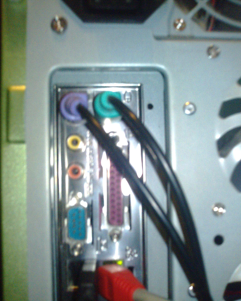

zack Posted October 7, 2006 Share Posted October 7, 2006 Eu personal ma gandeam sa al bag prin auxiliar... De ce sa zic...nu ma pricep cine stie ce. Am o mufa de care zice Vaxxi. Credeam ca o sa bag un cablu rca in "gaura" rosie de la pc(vezi poza) este spdif-out si sa al fi bagat in audio - aux in. Ma insel ?! Link to comment
vio.p Posted October 7, 2006 Share Posted October 7, 2006 (edited) Cum scapi de pop-upSetup-up pentru genuine advantage notification il gasesti in C:\windows\SoftwareDistribution\ Download\6c4788c9549d437e76e1773a7639582a Cam asta e. Ar trebui sa mearga fara probleme. Nu are rost acum sa reiau discutia despre cat e de bine sau nu e sa ai soft licentiat. Multumesc pentru indrumare. Am respectat pasii, iar totul este ok. Doar ca fisierul "c:\windows\system32\WgaLogon.dll" nu am putut sa l sterg si... "c:\windows\system32\spmgs.dll" e ... spmsg.dll N am gasit acel fisier "6c4788c9549d437e76e1773a7639582a.." ... PS: Multumesc mult .. raman dator Edited October 7, 2006 by vio.p Link to comment
bogdan_o Posted October 8, 2006 Share Posted October 8, 2006 Da, ai dreptate. E spmsg.dll si nu spmgs.dll (eroare de dactilografiere). Ca sa scapi de wgalogon.dll incearca MoveOnBoot. E gratuit si e foarte util in astfel de situatii. http://www.snapfiles.com/get/moveonboot.html Sau, daca nu, intra in recovery console (rulezi setup-ul de pe cd-ul cu xp si cand te intreaba daca vrei sa faci repair using recovery console apesi pe tasta r). Iti va cere credentials-ul de admin (deci introdu numele administratorlui local si parola) si apoi te va lasa intr-un shell de dos. De aici e simplu. Ii dai del /Q /F %Windir%\system32\wgalogon.dll. Dar banuiesc ca e mai simplu cu move on boot. Link to comment
