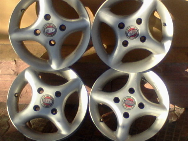

vali-05rzj Posted January 8, 2012 Share Posted January 8, 2012 la multi ani ! am facut rost de un set jante aliaj , ptr TICO , marca ATP 4*114,3 5,5j 13h2 et35. ce caucicuri sa pun;145/70r13--155/65r13--155/70r13. sau astea scumpe ,165/55r13. Link to comment
Alex_84 Posted January 14, 2012 Share Posted January 14, 2012 la multi ani ! am facut rost de un set jante aliaj , ptr TICO , marca ATP 4*114,3 5,5j 13h2 et35. ce caucicuri sa pun;145/70r13--155/65r13--155/70r13. sau astea scumpe ,165/55r13. 155/65 r13 parerea mea... Link to comment
vali-05rzj Posted January 15, 2012 Share Posted January 15, 2012 unde gasesc piulite ptr. jantele de aliaj acum, ca trebuiesc mai mari ,cu hexagon de 19 si filert 10*1,25 Link to comment
vali-05rzj Posted January 30, 2012 Share Posted January 30, 2012 am facut rost de piulite,cu hexagon de 19. si filet m10*1,25 Link to comment

vali-05rzj Posted February 6, 2012 Share Posted February 6, 2012 faci rost de suruburi conice ptr. roti si le dai la un strungar sa le faca, adica sa taie partea filetata si la capul surubului ,sa dea gaura si filet m10*1,25. vezi sa ai grija sa probezi intii ce tybulara intra pa gaurile de la jante {jante de aliaj} si pe urma sa faci rost de suruburi. in acelasi timp ,poate iti face si antifurturi Link to comment
