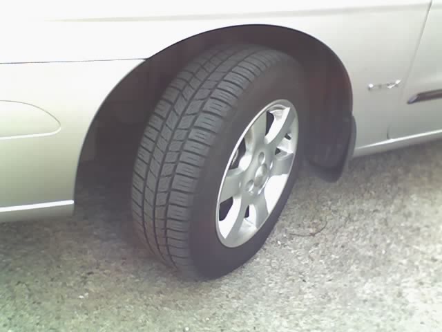

dinoc Posted October 6, 2005 Share Posted October 6, 2005 (edited) CMS-urile pe 14 cu ET 35 (6Jx14 cu pneuri 185/65 R14) nu freaca - garantat - am eu pe masina acum Edited October 6, 2005 by dinoc Link to comment

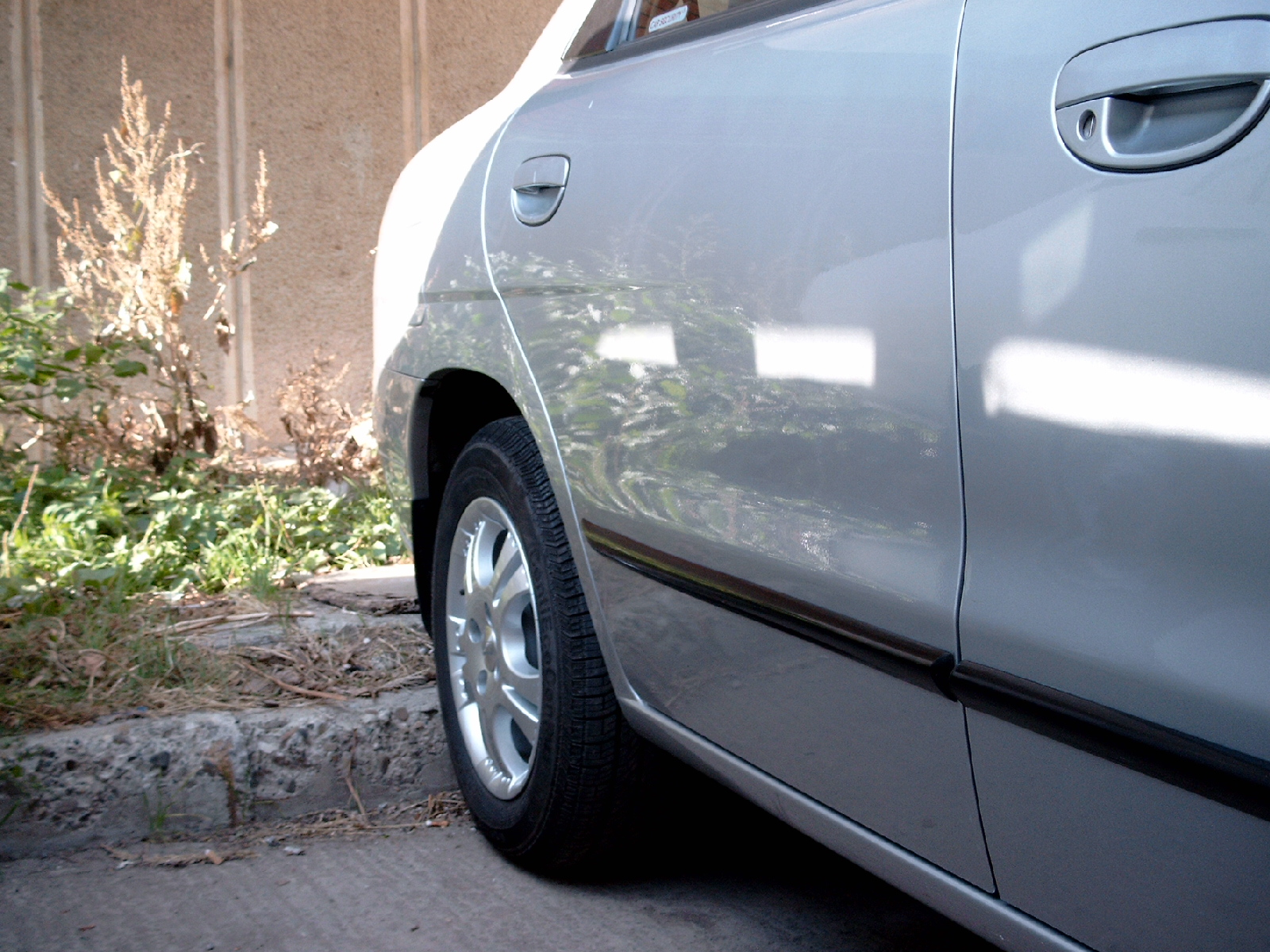

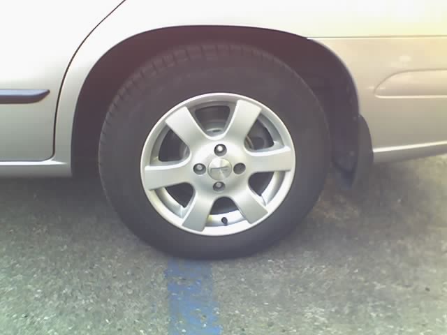

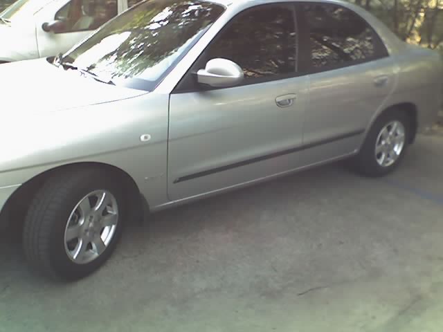

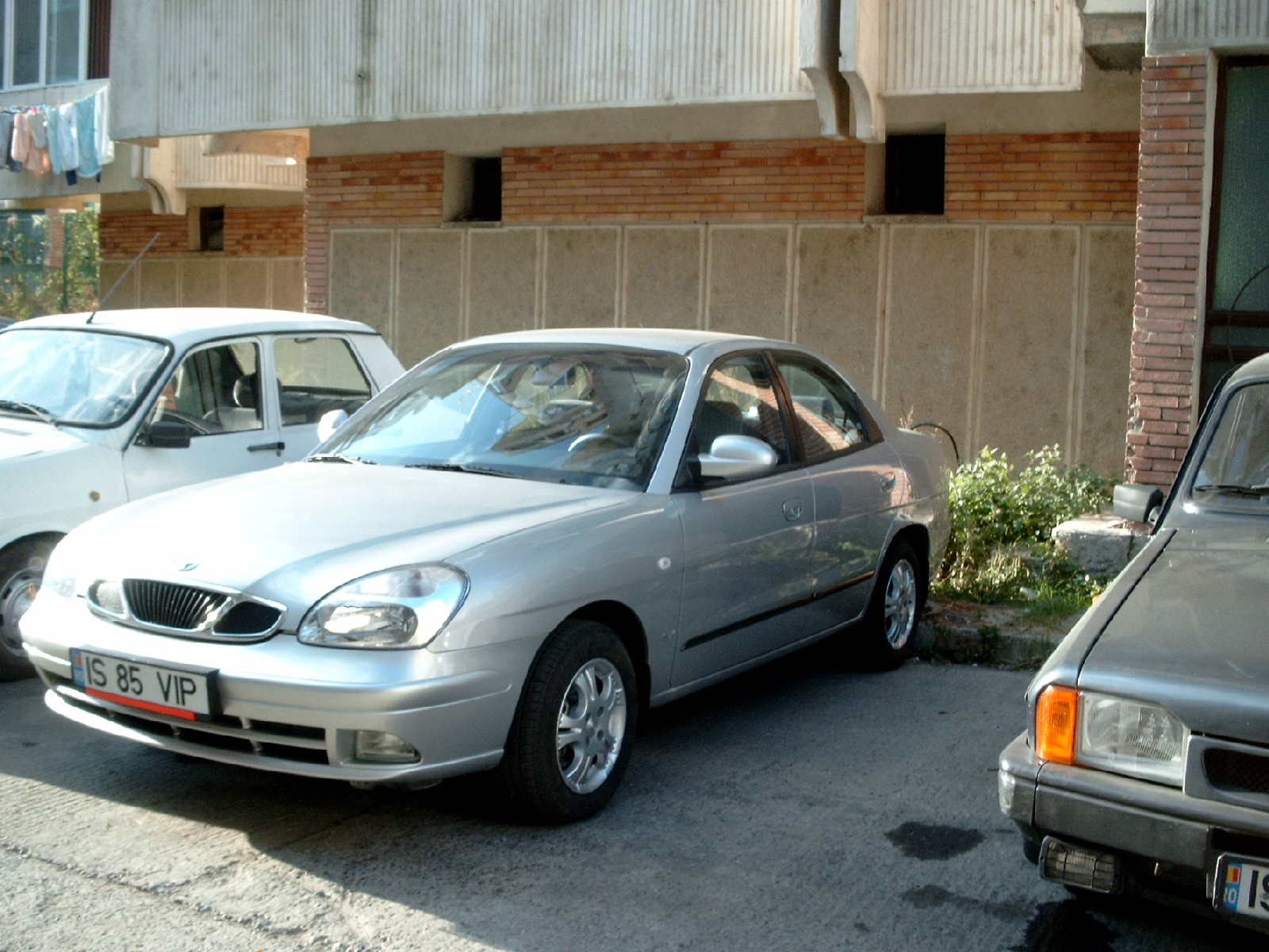

andreib Posted October 6, 2005 Share Posted October 6, 2005 Uitati aici poze cu jantele. Nu am un profil calumea pt ca maina era in parcare. Nu ating nicaieri, s-au montat fara probleme dar ATENTIE!!! NECESITA INELE DE CENTRARE. In Metro se vand fara inele de centrare. Acestea pot fi cumparate (probabil) de la importator (Radacini Bucuresti) sau confectionate de un strungar din plastic/aluminiu/teflon/fier. Link to comment

dinoc Posted October 6, 2005 Share Posted October 6, 2005 tot pe 14 inch jante CMS 6Jx14 ET35 - cu pneuri Pirelli 185/65 R14 - nu freaca defel - testate Link to comment
andreib Posted October 6, 2005 Share Posted October 6, 2005 Iti spun SIGUR ca nu ating, eu car cu masina asta diverse si se lasa sarca de numa-numa dar cauciucurile nu ating in aripi. In schimb daca as vrea sa pun cauciucuri mai late sigur as avea probleme deoarece astea trec milimetric pe langa arcele rotilor in spate. Link to comment
dinoc Posted October 6, 2005 Share Posted October 6, 2005 milemetric pe langa arcuri ??? da' ce ET ai la jante ? trebuie sa-l ai foarte mare (adica roata intra adanc inuntru) daca zici ca trece milimetric ... Link to comment
andreib Posted October 6, 2005 Share Posted October 6, 2005 Prin arce ma refer la pasajele rotilor (nu la arcuri ) ), la buza interioara a aripii spate. Link to comment

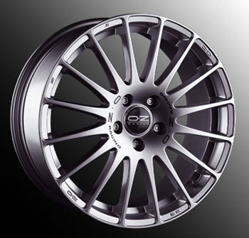

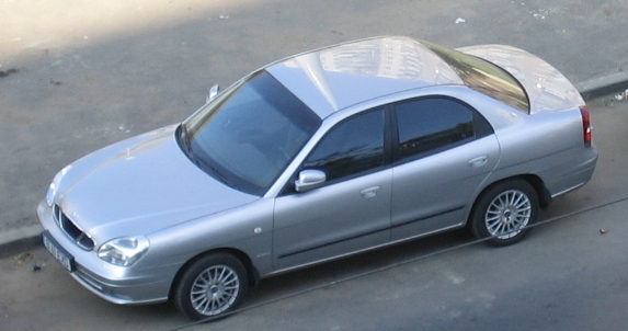

dinoc Posted November 7, 2005 Share Posted November 7, 2005 (edited) Abia acum am vazut posturile ... ati stricat surpriza ) Uite si Nubira cu jantele de 15 inch OZ RACING 6,5Jx15 ET43 si pneuri Dunlop SP9000 195/55 R15 (ca si in talon) profil V (nu se vad in poza asta - fiind facuta mai de la departare). Edited November 7, 2005 by dinoc Link to comment
silviustel Posted November 7, 2005 Share Posted November 7, 2005 (edited) Cum ai putut adapta janta pe 5 prezoane, exista adaptare? Ca daca da ar fi bine pt ca am vazut cateva modele frumoase pe care mi le-as lua si erau in 5 prezoane. P.S.: sunt frumoase si jantele acelea CMS, de care spuneai mai sus. Te-ai gandit la un pret pt ele? Edited November 7, 2005 by silviustel Link to comment
dinoc Posted November 7, 2005 Share Posted November 7, 2005 Jantele sunt in 4 prezoane (poza a 2-a) este de pe site-ul oficial Ozracing - si in poza este prezentat modelul cu 5 prezoane (exista si in 4 prezoane) ... am sa mai postez alte fotografii mai bune. PS> CMS-urile si-au gasit un nou proprietar Link to comment

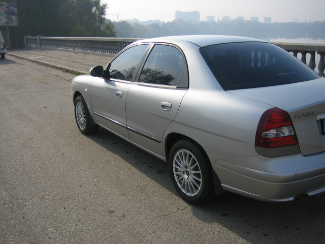

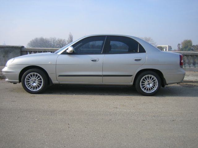

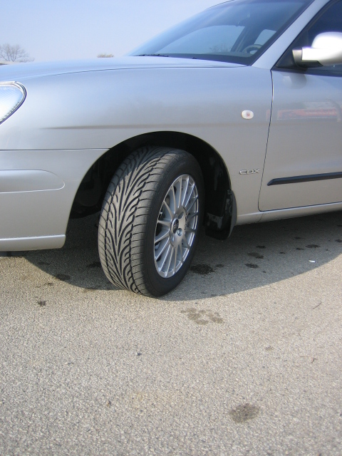

dinoc Posted November 8, 2005 Share Posted November 8, 2005 Cum am promis, revin cu fotografii (jantele de 15 inch OzRacing 6,5Jx15 ET43 + pneuri Dunlop Sp 9000 195/55 R15) PS> n-am putut edita post-ul de dinainte ... Link to comment
Sharpe Posted November 11, 2005 Author Share Posted November 11, 2005 Sa le stapanesti sanatos! Dar...dupa parerea mea,jantele astea dau ff bine cu talon mai mic. Dupa gustul meu sunt putin cam incarcate,ca model(nu pt ca strugurii sunt acri),ci pt ca arata altfel(modelul) pe Nubira decat pe alte tipuri de masina. Se adevereste inca o data zicala"nu-i frumos ce e frumos,e frumos ce-mi place mie!" Link to comment
dinoc Posted November 11, 2005 Share Posted November 11, 2005 (edited) Si mie mi-ar fi placut cu talon mai mic ... (initial vroiam 195/50 R16 sau 205/45 R16) - dar am renuntat din cauza drumurilor proaste de la noi, mai iau cate o groapa, mai urc o bordura ... Plus ca jantele de 16 sunt si mai grele (cele de 15 pe care le am acum sunt aproximativ la fel de grele ca si jantele de 14 stock) - iar unele usoare de 16 gasesti la preturi foarte mari. Iar din cate stiu chiar si tu Sharpe cu talonul ala de 50 cam fereai bordurile, nu ? Apropos, tu ce-ai mai facut cu ale tale roti, jante - stiu ca-ti frecau cu ET38 parca - le-ai schimbat sau ti-ai pus arcuri sport ? Edited November 11, 2005 by dinoc Link to comment
