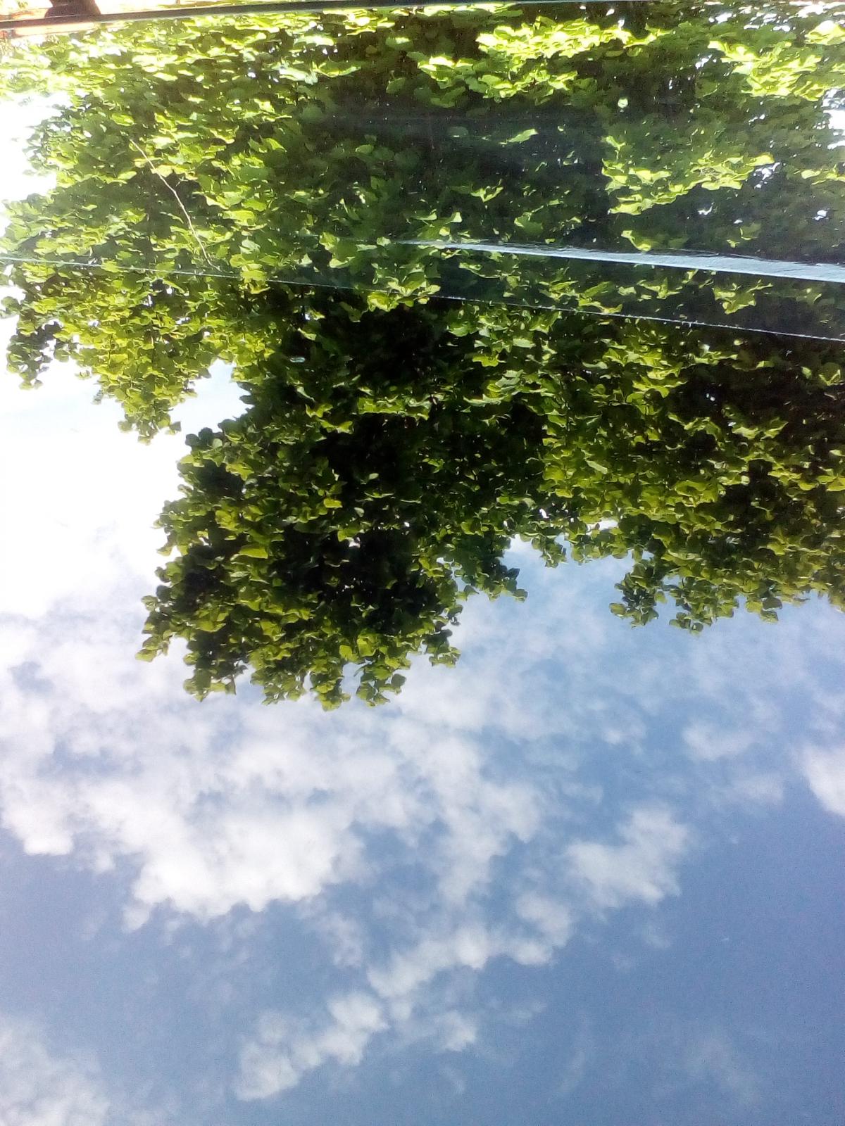

Viktor Posted June 9, 2016 Share Posted June 9, 2016 Prevent-ul , inca face treaba faina . Cu mult mai bun decit Turtle, parerea mea. Link to comment
