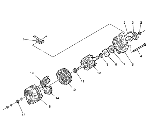

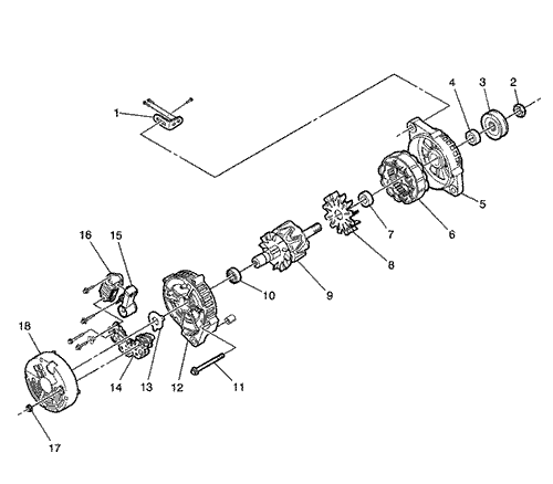

cristi_vb Posted April 18, 2008 Share Posted April 18, 2008 Ajutati-ma si pe mine ca sunt tampit. Unde e amplasat releul de incarcare ca de o jumatate de ora ma uit ca curca in lemne si nu imi dau seama unde e. Link to comment
tolin Posted April 18, 2008 Share Posted April 18, 2008 (edited) tip A - MANDO - poz.14 tip B - DAC - poz.14 Edited April 18, 2008 by tolin 1 Link to comment
smailmiami Posted April 18, 2008 Share Posted April 18, 2008 (edited) cristi_vb said: Ajutati-ma si pe mine ca sunt tampit. Unde e amplasat releul de incarcare ca de o jumatate de ora ma uit ca curca in lemne si nu imi dau seama unde e. E corp comun cu alternatorul. E "intins "cam pe o treime din spatele alternatorului. E 16-le in prima poza si 14-le in a doua. Edited April 18, 2008 by smailmiami Link to comment
