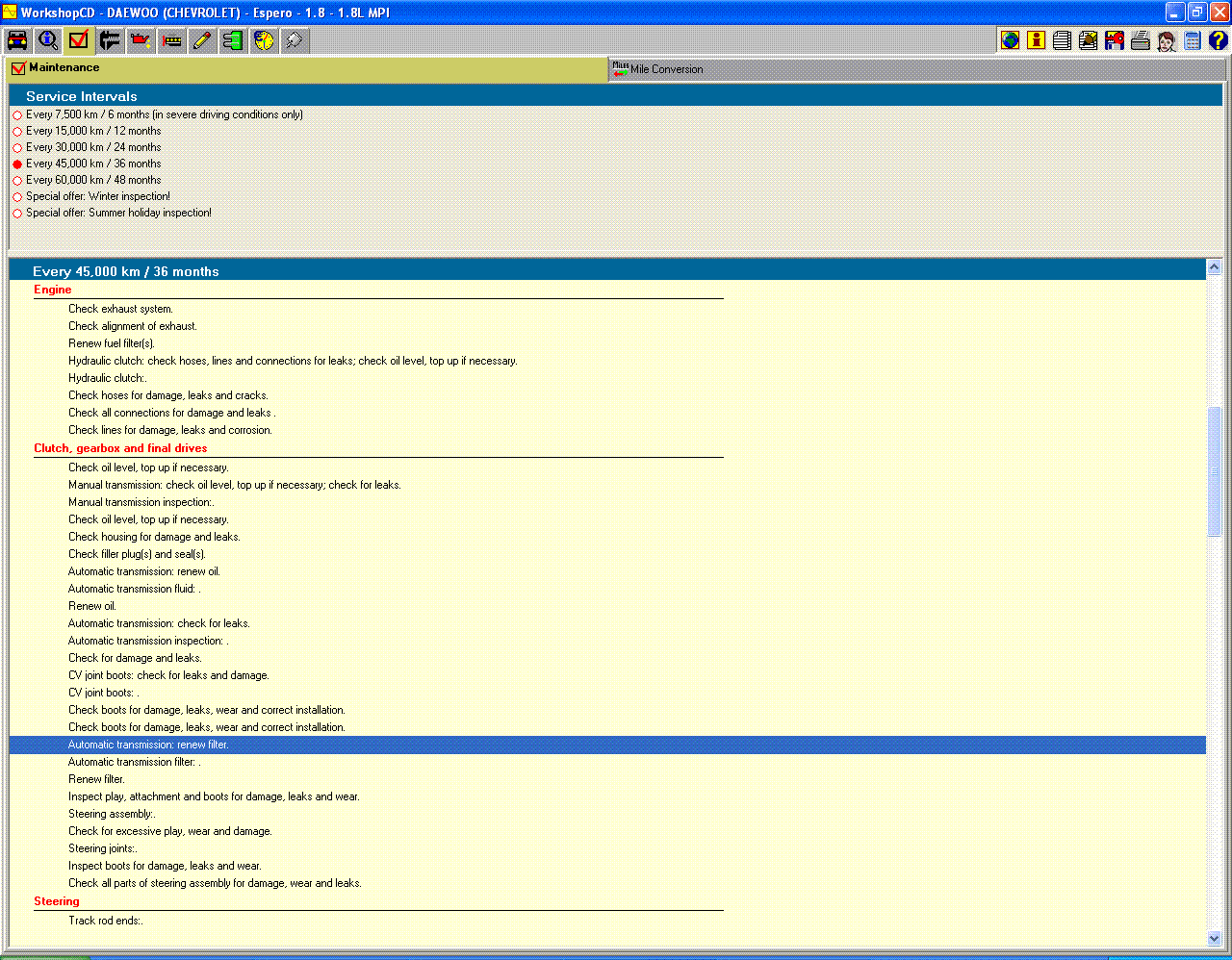

tatabobu Posted August 15, 2005 Share Posted August 15, 2005 Asa scria intr-o documentatie pe care ma uitam. Uite si un printscreen. "Minte aia mint si eu!" "> Link to comment
van den plas Posted August 15, 2005 Share Posted August 15, 2005 Asa o fi, eu n-am nimic impotriva, mai trebuie convinsi si mecanicii. Link to comment

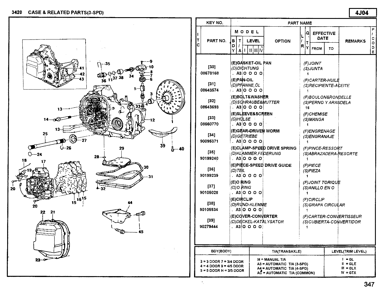

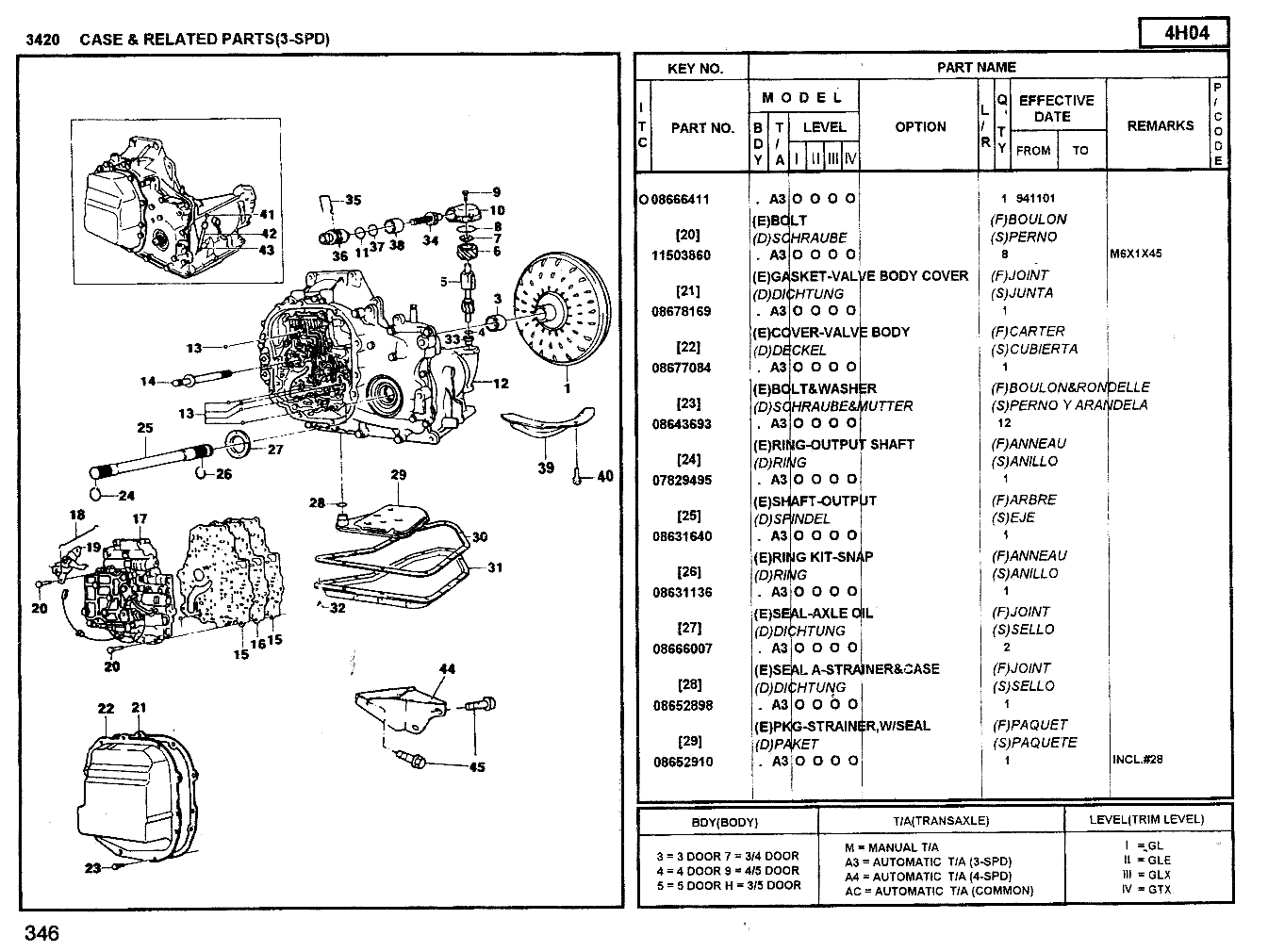

ovi_jer Posted August 27, 2005 Share Posted August 27, 2005 Are sigur filtru.Pina nu dai baia de ulei jos nu ai cum sa iti dai seama daca se potriveste cu cel de cielo sau nu. Mai jos sant schemele si reperele de la filtru,garnitura,etc. Link to comment
