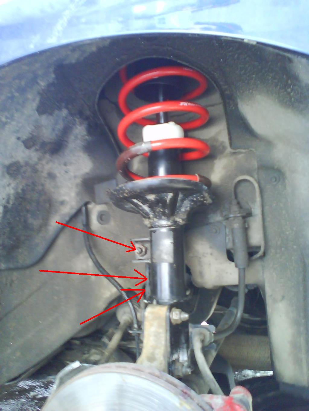

nino Posted November 23, 2010 Share Posted November 23, 2010 Verifica si bieletele de la bara stabilizatoare... Link to comment

Rafi Posted November 23, 2010 Share Posted November 23, 2010 (edited) chestia aia subtire Edited November 23, 2010 by Rafi Link to comment

nino Posted November 23, 2010 Share Posted November 23, 2010 Mircea, te contrazic... la mine, stand pe loc si rotind de volan "pocnea" capatul unei bielete stabilizatoare fata... Cosmin25, probabil ai ceva pe la IAC sau ceva furtunase de vacuum cu scapari... Link to comment
dariomario Posted November 24, 2010 Share Posted November 24, 2010 @nino: ideea e ca se aude cand intorci stanga dreapt scurt (5-6 grade) deci aia e , pt bieleta aia ma gandesc ca trebuie sa intorci mai mult ca sa se aude. Link to comment
