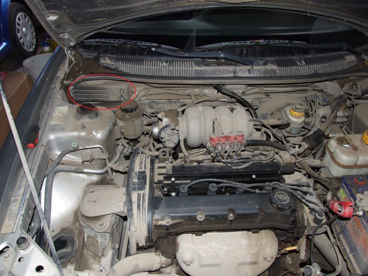

mike.omega Posted January 26, 2014 Share Posted January 26, 2014 (edited) Salut! Da, are filtru de habitaclu (eventual cu polen). Ridici capota de la motor si in stanga (in fata pasagerului din dreapta) regasesti un capac negru dreptunghiular fixat cu doua piulite pe care le desfaci cu cheia de 10. Are si vreo doua furtunase capacul cu pricina. In mod evident, filtrul e in spatele acelui capac. Edited January 26, 2014 by mike.omega Link to comment

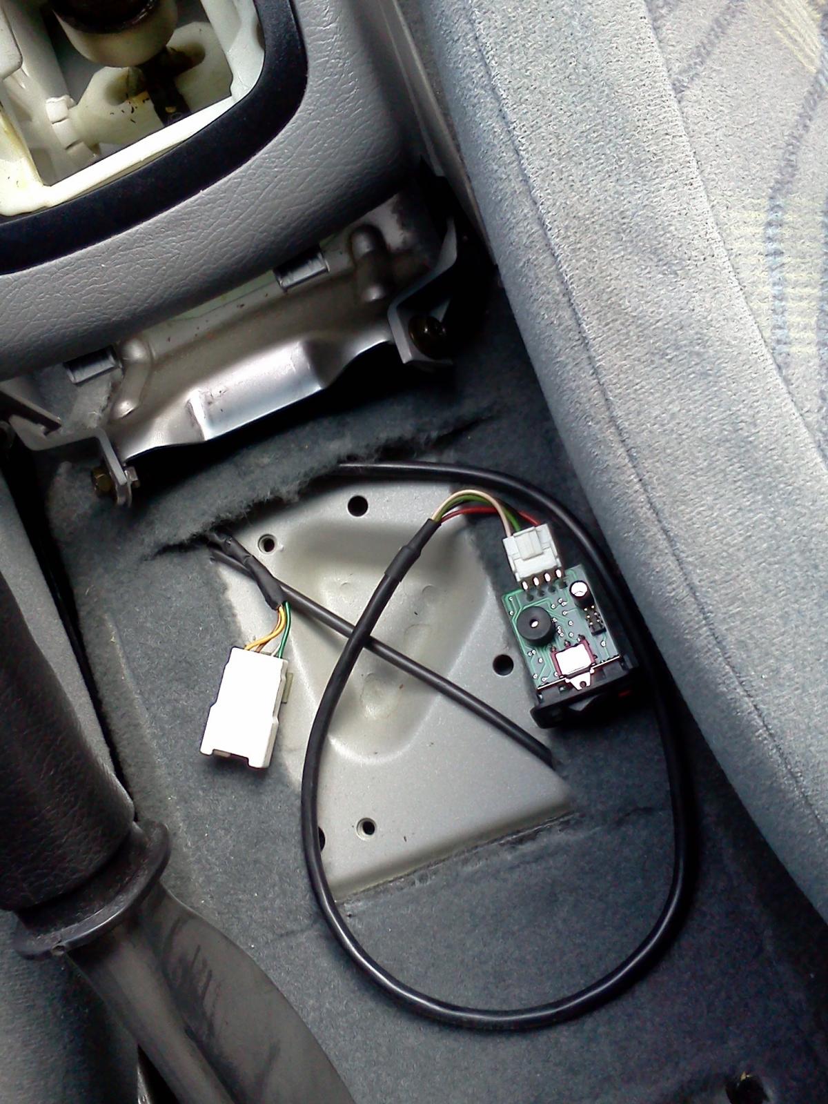

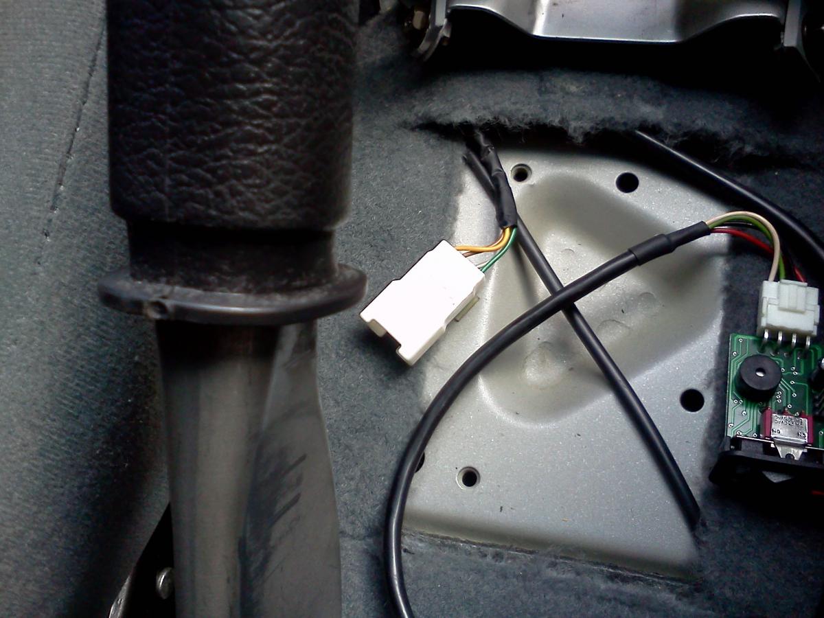

Marian_MYT Posted April 26, 2014 Share Posted April 26, 2014 (edited) Salutare, Stie cineva de la ce poate fi mufa din partea stanga a pozei ? Se afla sub consola de la frana de mana, m-am tot chinuit sa imi dau seama de unde provine sau la ce ar putea fi folosita, dar nu am reusit sa gasesc un raspuns. Poate ma ajutati voi . Multumesc frumos, Edited April 26, 2014 by Marian_MYT Link to comment
mike.omega Posted April 27, 2014 Share Posted April 27, 2014 (edited) Salut! Eu am acolo un senzor de la alarma, teoretic daca imi ridica masina, porneste alarma, doar teoretic Nu mai stiu daca e legat de mufa aia sau nu. Daca nu, trebuie vazut la un model cu Airbag-uri daca nu cumva are legatura cu partea aia. Edited April 27, 2014 by mike.omega Link to comment
Corneda Posted April 27, 2014 Share Posted April 27, 2014 Sau ar putea sa fie mufa de alimentare a becurilor ce lumineaza vitezele la variantele automate. Link to comment

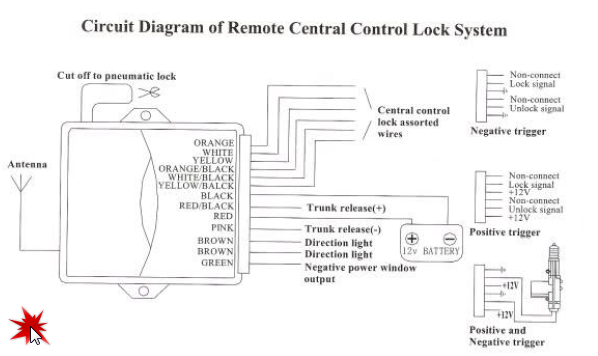

catalinxjoker Posted June 11, 2014 Share Posted June 11, 2014 salutare, vreau sa montez inchiderea centralizata pe o nubira 2 si nu gasesc mufa de la antena. pe unde dau de ea? Link to comment
augustinionut Posted June 11, 2014 Share Posted June 11, 2014 Vrei sa-i dai una-n mufa antenei? Care antena, radio a masinii, a telecomenzii, a modulului de inchidere centralizata, care ma indoiesc c a are antena, a alarmei, a Satelor? Link to comment
catalinxjoker Posted June 11, 2014 Share Posted June 11, 2014 (edited) a modulului de inchidere. nu stiu unde trebuie legata. Edited June 11, 2014 by catalinxjoker Link to comment
cris06 Posted June 11, 2014 Share Posted June 11, 2014 N-ai treaba cu firul ala! E pentru receptie semnal de la telecomanda. Du masina la un mester in alarme. Vezi ca iti trebuie si un actuator cu 5 fire. Esti Offtopic. Cauta in sectiunea dedicata. Link to comment
