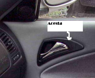

Depecher Posted June 25, 2009 Share Posted June 25, 2009 (edited) Dragi forumisti va rog sa-mi spuneti cum naibii reusesc sa scot plasticul acela negru de la deschizatorul de usa.Va rog sa-mi spuneti mai detaliat daca sunt mai multe operatii? Este prins in surub,cleme? Edited June 25, 2009 by Depecher Link to comment
andreib Posted June 25, 2009 Share Posted June 25, 2009 Este prins in cleme si se scoate prin tragere, cu manerul tras, putin in fata. Necesita ceva forta operatiunea, nu este una tocmai delicata. Link to comment
Depecher Posted June 26, 2009 Share Posted June 26, 2009 Multam Andrei! Nu am tras mai tare deoarece mi-a fost teama sa nu se rupa plasticul. Link to comment

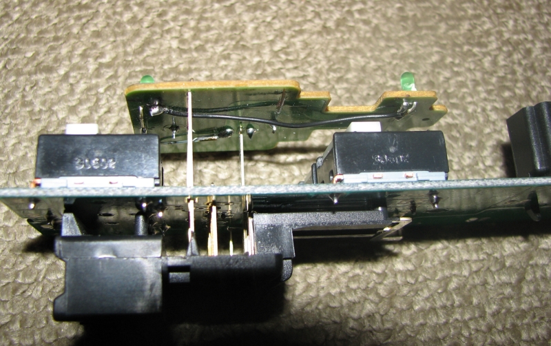

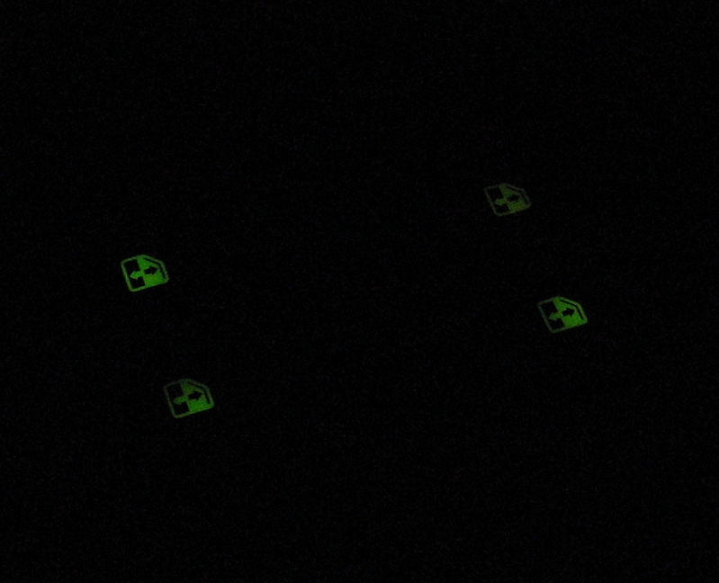

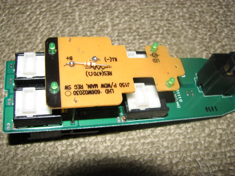

Depecher Posted June 27, 2009 Share Posted June 27, 2009 (edited) Gata am rezolvat.Multumita indicatiilor lui Vali(Ches) si lui Andrei am reusit sa pun leduri la cele 4 butoane de peconsola. Va multumesc tuturor. Edited June 27, 2009 by Depecher Link to comment
