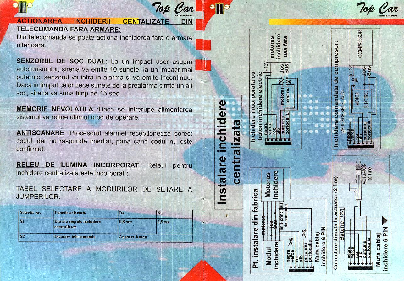

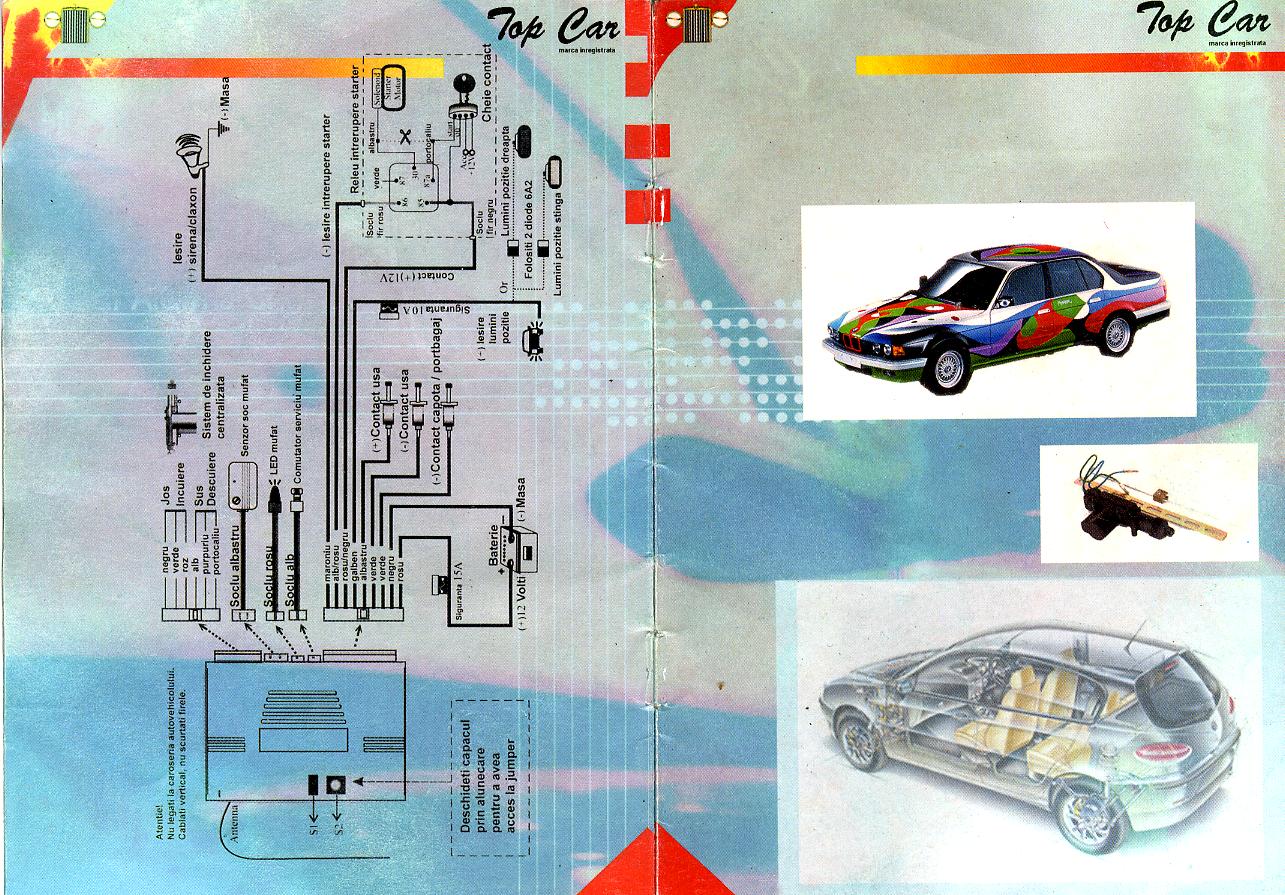

ToPser Posted August 7, 2006 Share Posted August 7, 2006 pun aici scan-urile ptr ca au cerut pe mail mai multi oameni manualul Link to comment
