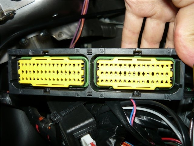

augustinionut Posted January 31, 2011 Share Posted January 31, 2011 (edited) Stie cineva cum arata pinul la tipul asta de mufa? Edited January 31, 2011 by augustinionut Link to comment
calinjack Posted January 31, 2011 Share Posted January 31, 2011 On 1/31/2011 at 6:16 PM, augustinionut said: Stie cineva cum arata pinul mama la tipul asta de mufa? Nu stiu ce vrei sa spui cu asta dar mie mi se pare ca asta-i mama.Probabil ca vrei sa afli cu arata tata.. Link to comment
augustinionut Posted January 31, 2011 Share Posted January 31, 2011 (edited) Vreau sa aflu cum arata contactul dinauntru.. sa pun unul in gaura 8.. tolin, inauntru e pinul MAMA. Edited January 31, 2011 by augustinionut Link to comment
madkat Posted February 1, 2011 Share Posted February 1, 2011 ceva de genul asta arata: http://www.clockwisemotion.co.uk/index/honda-k20-programmable-ecu/honda-k20-ecu-connector.html Link to comment
augustinionut Posted February 1, 2011 Share Posted February 1, 2011 Multumesc. "Ma benoclez acu", ca are rezolutie mica. Link to comment
madkat Posted February 1, 2011 Share Posted February 1, 2011 Io as incerca la dezmembrari - o bucata de cablaj cu mufa de genul asta - si extragi doar un pin, si ai si o bucata de fir pe el, mai simplu de legat. Sau - magarie oleaca dar poate merge - cauti un pin neocupat la tine, dar cu fir in cablaj, gen comanda AC, cutie automata etc - si scoti pinul si il muti unde iti trebuie, evident deviind firul nefolosit. Link to comment
augustinionut Posted February 1, 2011 Share Posted February 1, 2011 Merci de sfat, insa nu desfac mufa bucatele sa scot pinul refolosibil. Mi-e frica Atata matiz am si eu. Plus ca spatiul e asa de ingramadit sub bord... nu-mi ajunge sa stau cu 2 maini sa umblu in mufa. M-am gandit si eu la asta, insa nu am timp decat sambata, atunci cand am. Link to comment

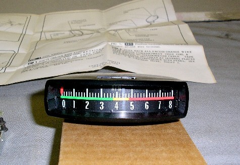

augustinionut Posted February 24, 2011 Share Posted February 24, 2011 A vazut cineva vreodata asa ceva de cumparat?? Link to comment
calinjack Posted February 24, 2011 Share Posted February 24, 2011 (edited) Nu,da de ce intrebi? Edited February 24, 2011 by calinjack Link to comment

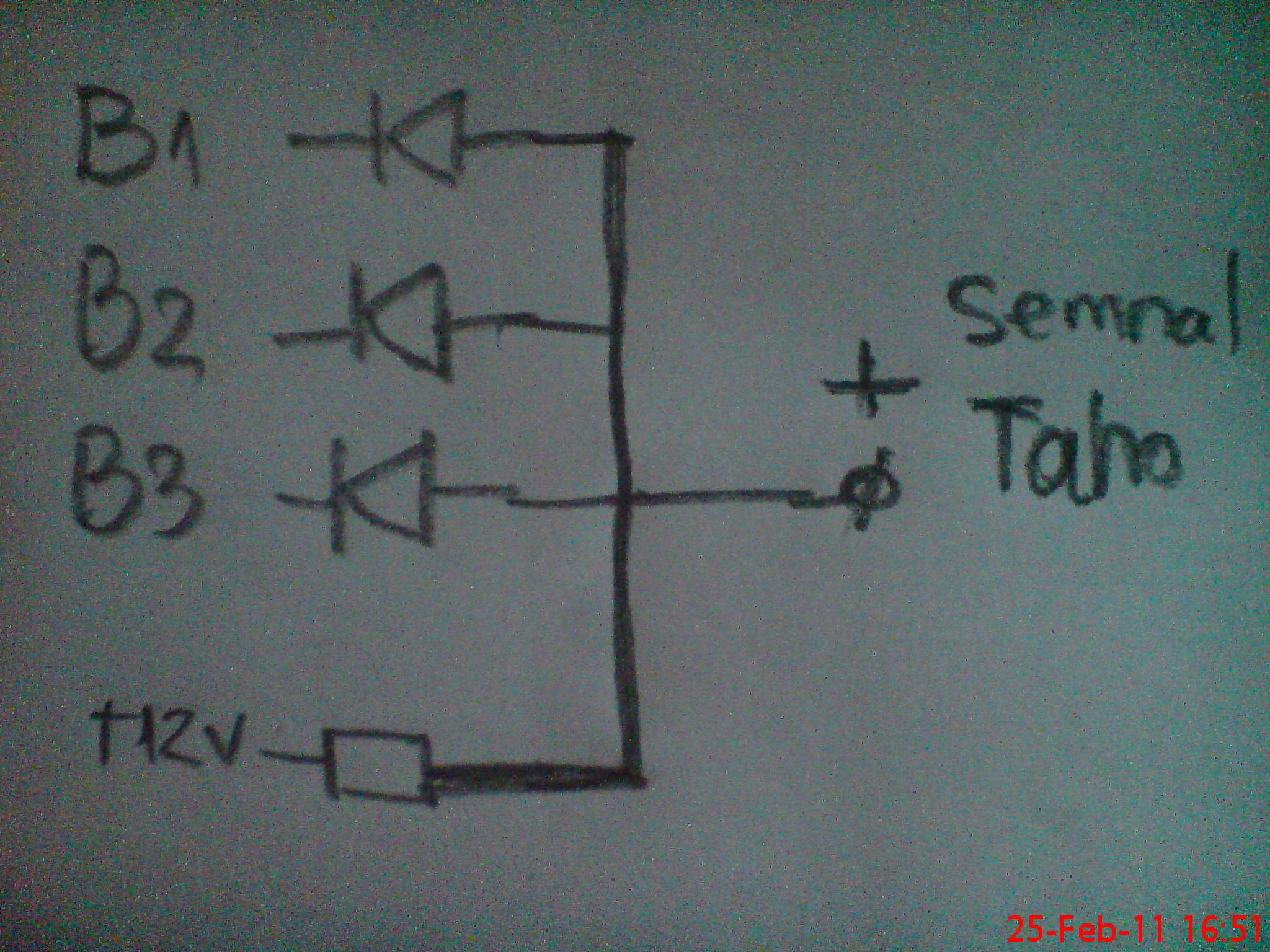

calinjack Posted February 25, 2011 Share Posted February 25, 2011 Am inteles bine schema sumatorului? Link to comment
augustinionut Posted February 26, 2011 Share Posted February 26, 2011 DA. EDIT: am reeditat pentru a nu lua warn pentru posturi "onomatopeice". Link to comment

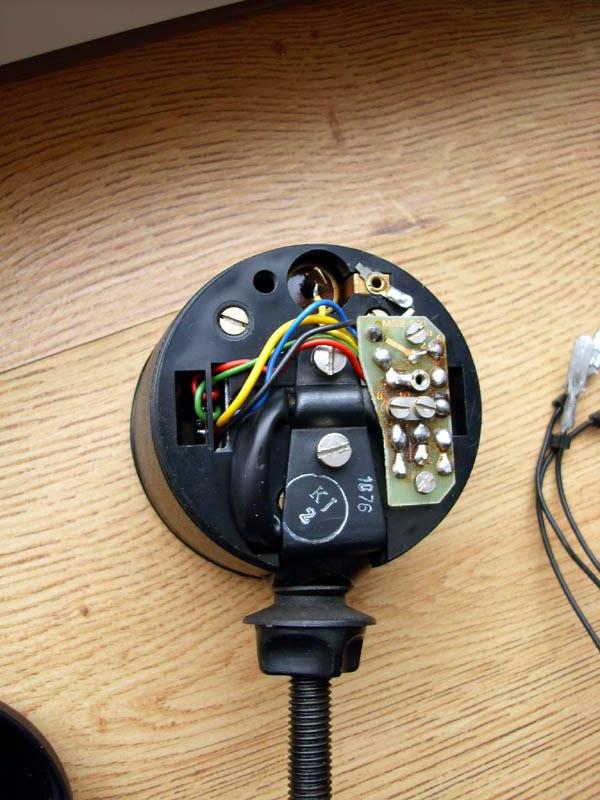

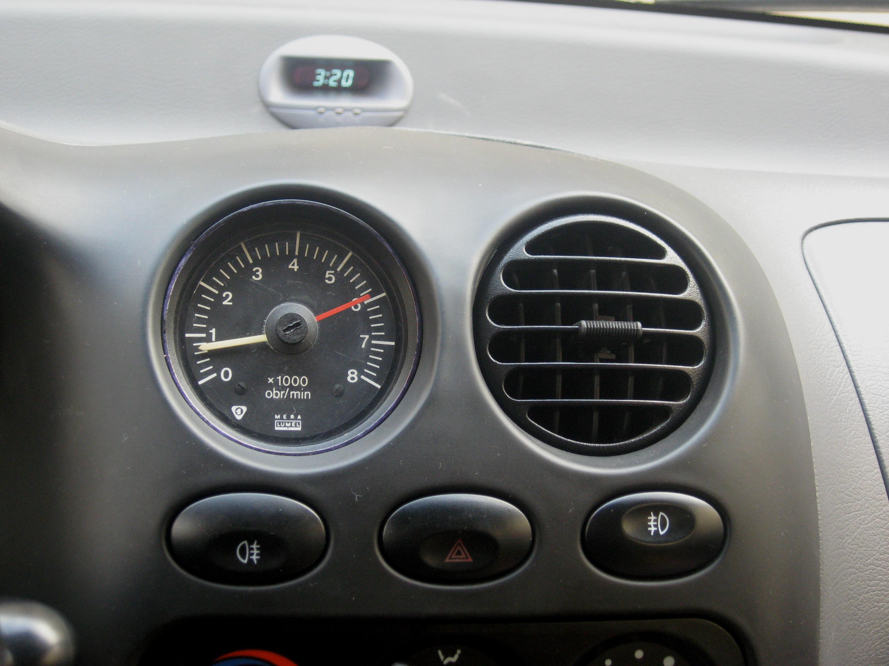

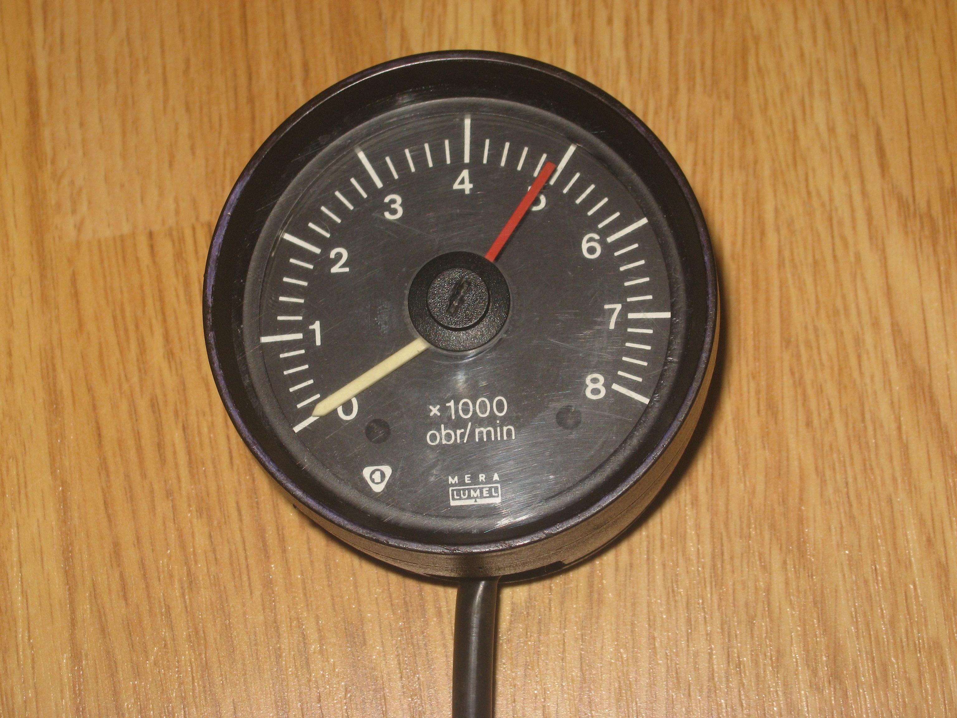

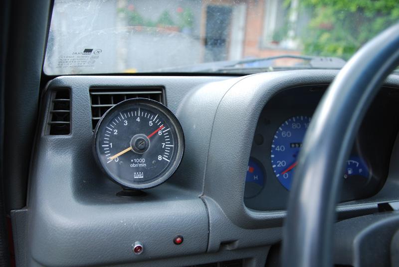

lperisoara Posted April 10, 2011 Share Posted April 10, 2011 In urma cu trei saptamani in targ, pe Valea Cascadelor, am gasit la o tiganca un turometru, pe care cerea numai 7 lei. Am zis ca merita investitia chiar si numai pentru carcasa si ampermetru. Pe net am gasit ca se cheama Mera Lumel MS2, de origine poloneza, fiind produs pentru Fiat 126p. l-am probat si surpriza mare: chiar functioneaza !!! Problema e ca poate fi setat pentru cap scala 6000 rpm: - 200 Hz: 4 cilindri, 4 timpi (Dacie, Lada), 2 cilindri, 4 timpi (Fiat 500, Fiat 126p) - 100 Hz: 2 cilindri, 2 timpi (Trabant) In interior are un potentiometru care cred ca este pentru reglarea capului de scala, dar este fixat cu vopsea si nu am putut sa-l reglez pentru 150 Hz (3 cilindri, 4 timpi - Matiz). Cred ca o sa schimb potentiometrul cu totul... Zilele trecute cand stateam in Matiz si admiram bordul mi-am dat seama ca diametrul fantelor de aer este cam de acelasi diametru (8 cm) cu turometrul meu. Si am zis: gata! Am gasit unde sa-l pun!!! Zis si facut... Sambata l-am instalat!!! Am Matiz Euro 2, astfel ca am facut legaturile: - semnal luat de la bobina inductie, fir 1, DK GRN / BLK - alimentare + 12 V prin contact de la mufa casetofon, fir 4, YEL - masa de la mufa casetofon, fir 11, BLK - iluminare de la mufa casetofon, fir 3, GRY/WHT Pentru fixarea mecanica, am scos duza de orientare aer din rama bord. Pe tubulatura de aer am pus o folie groasa de plastic lipita cu silicon pe interior si cu banda adeziva pe exterior. Carcasa turometrului intra un pic fortat in tubulatura aer, vreo 3 cm. Deoarece turometrul avea un pic de joc in rama de bord, am mai pus un pic de banda adeziva ca sa fie mai gros, spre partea cu acul indicator. Astfel, intra un pic fortat in rama bord. Nu este fixat in suruburi si sta presat de rama bord. Din pacate, cand am facut montajul, am uitat sa iau aparatul foto. Iata ce a iesit: In probe, arata asa: ralanti 750 rpm treapta km/h rpm I 20 2800 30 4000 II 30 2300 60 4400 III 40 1900 60 2800 80 3700 IV 60 2000 80 2700 Practic, indicatia este la 3/4 din turatia normala a motorului. Urmeaza sa fie calibrat la cap de scara ... Desi e zgariat un pic, imi place cum se asorteaza cu bordul ... fundal negru, scris alb ... parca de acolo e !!! Acelasi turometru l-am gasit montat si pe un tico, la polonezi: 1 Link to comment
miborion Posted April 11, 2011 Share Posted April 11, 2011 (edited) @ Genial!! Super tare integrarea in bord...dar ce pb este cu cele euro 3 (matiz) de spui ca merge doar pe euro 2? Mersi, Edited April 11, 2011 by Salex Citare inutila, intregrala a postului anterior. Foloseste AddReply sau Fast Reply !! Link to comment
