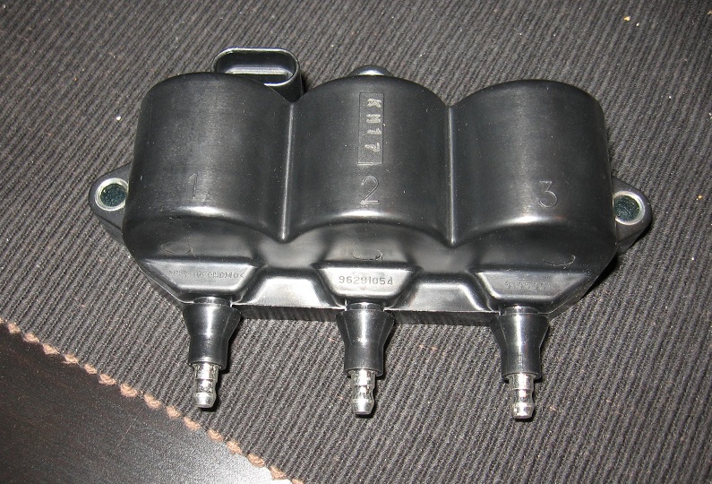

wwillym Posted December 21, 2011 Share Posted December 21, 2011 Asa arata "delcoul" de la matiz E3/E4 Link to comment

calinjack Posted December 21, 2011 Share Posted December 21, 2011 On 12/21/2011 at 12:40 PM, wwillym said: Asa arata "delcoul" de la matiz E3/E4 asta-i bobinele de inductie! Link to comment
argon Posted December 22, 2011 Share Posted December 22, 2011 Noroc cu tine, ce sa zic.. Link to comment
