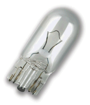

JAN_1980 Posted December 4, 2006 Share Posted December 4, 2006 Salut! Stie careva ce becuri are Leganza la pozitii ? Va multumesc ! Link to comment
