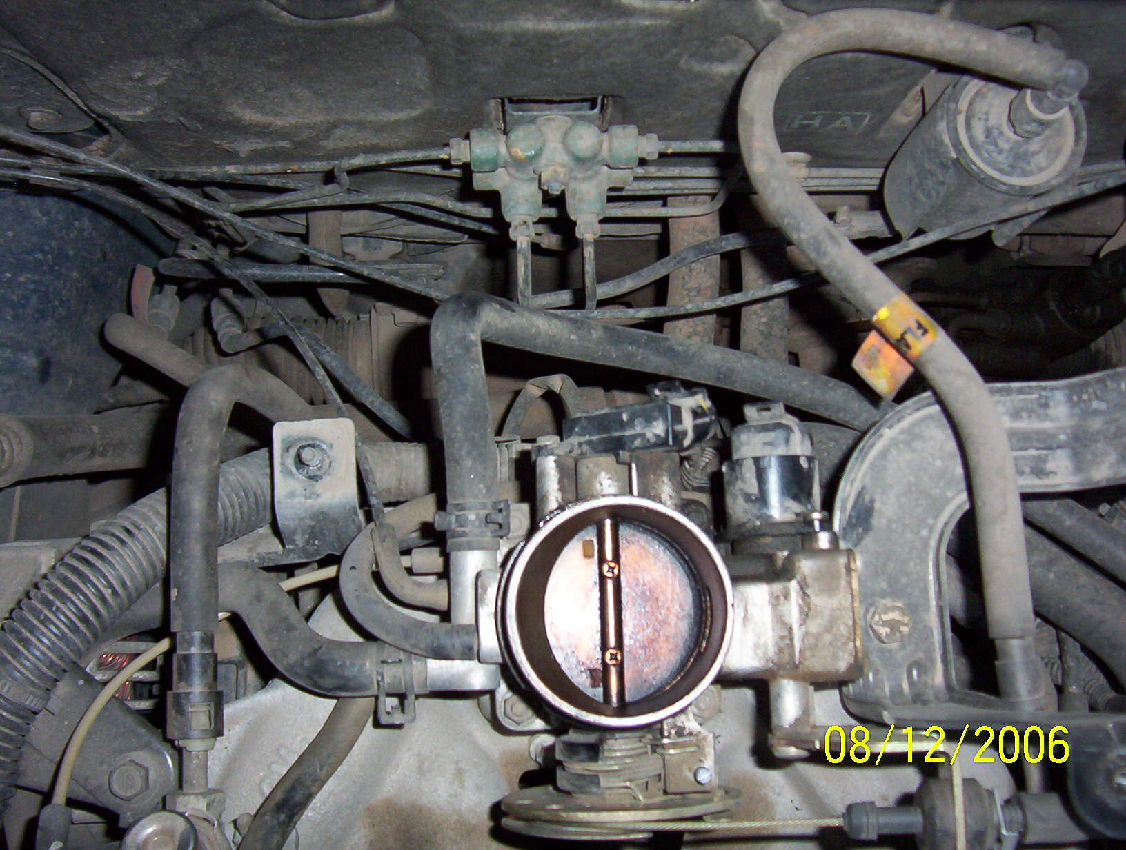

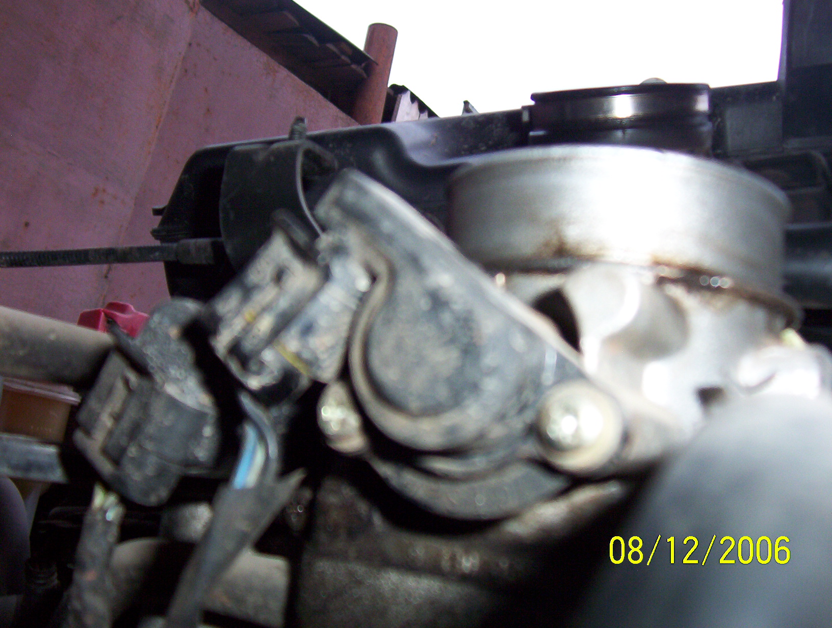

Engine Posted December 10, 2006 Share Posted December 10, 2006 Unde se afla IAC si senzorul TPS ? Link to comment
tolin Posted December 10, 2006 Share Posted December 10, 2006 In ambele poze, unul langa celalalt. Link to comment
Engine Posted December 10, 2006 Share Posted December 10, 2006 Privind foto facuta de sus, TPS e cel din dreapta sau din stanga. Cred ca ar fi cel din stanga, nu ? Link to comment
tolin Posted December 10, 2006 Share Posted December 10, 2006 In poza facuta din lateral, IAC-ul este in dreapta. TPS-ul nu poate fi decat solidar cu axul clapetei. Link to comment
MariusZMC Posted December 10, 2006 Share Posted December 10, 2006 In stanga e TPS si in dreapta IAC. Link to comment
Engine Posted December 10, 2006 Share Posted December 10, 2006 Aha, si mai bine acum. Multumesc. Link to comment
