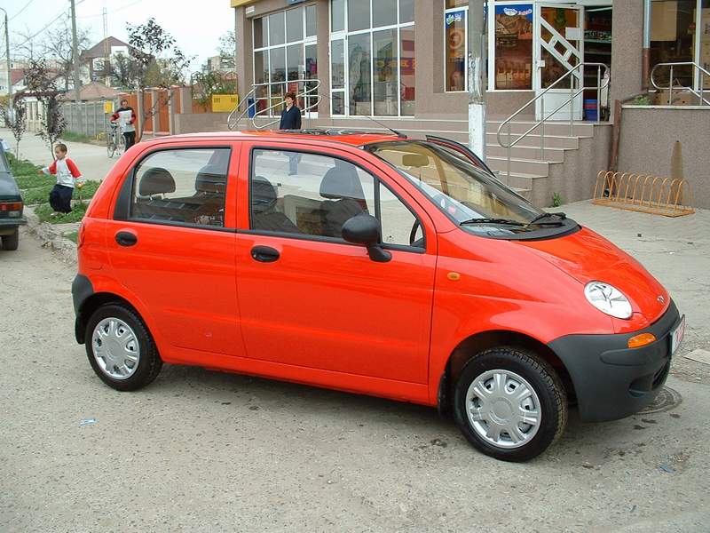

alfa Posted November 2, 2004 Share Posted November 2, 2004 vin si eu cu poza matizului :-D ...dupa o binemeritata spalare. Link to comment
alfa Posted November 2, 2004 Share Posted November 2, 2004 dupa cum v-am zis intr-un post anterior, pretena si-a luat "avatarul" care-l am; are deja vreo 500km (luata cu 25km) de la un dealer (Daewoo) din TM. Am citit ca la 1000 nu se face mare lucru, numai cateva verificari, si din cate am inteles trebuie NEAPARAT schimbat uleiul. Good 2 know :!: Anyway, chestia care ma deranjeaza cel mai mult e ca imi zdrangane ceva in spate, ceva plastic p'acolo. Am inteles ca la mai toate Matizurile le tremura cate ceva. :? . apropo...despre intalnire in TM se aude ceva ? Link to comment
john Posted November 2, 2004 Share Posted November 2, 2004 vad ca ai antena. e originala ? cum ai montat-o acolo ? p.s. scuze pt offtopic Link to comment
alfa Posted November 3, 2004 Share Posted November 3, 2004 off-topic: antena nu era originala. Mi-a montat-o tipul de la reprezentanta, care mi-a instalat si alarma,inchiderea si cas-ul. Link to comment
sprite Posted November 3, 2004 Share Posted November 3, 2004 fftopic: @alfa: Frumusel! Sa-l stapanesti sanatos! "> Link to comment
