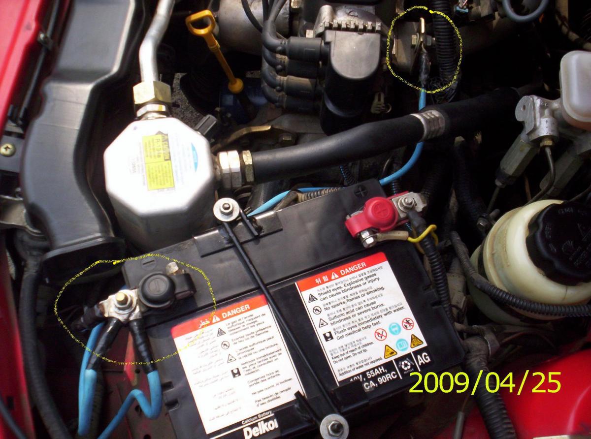

cris06 Posted March 11, 2012 Share Posted March 11, 2012 (edited) Mai pune unul in paralel: de la - baterie la urechea de ridicare a motorului. Vezi in poza, incercuite cu galben: La Espero e cam la fel. Edited March 11, 2012 by cris06 Link to comment
