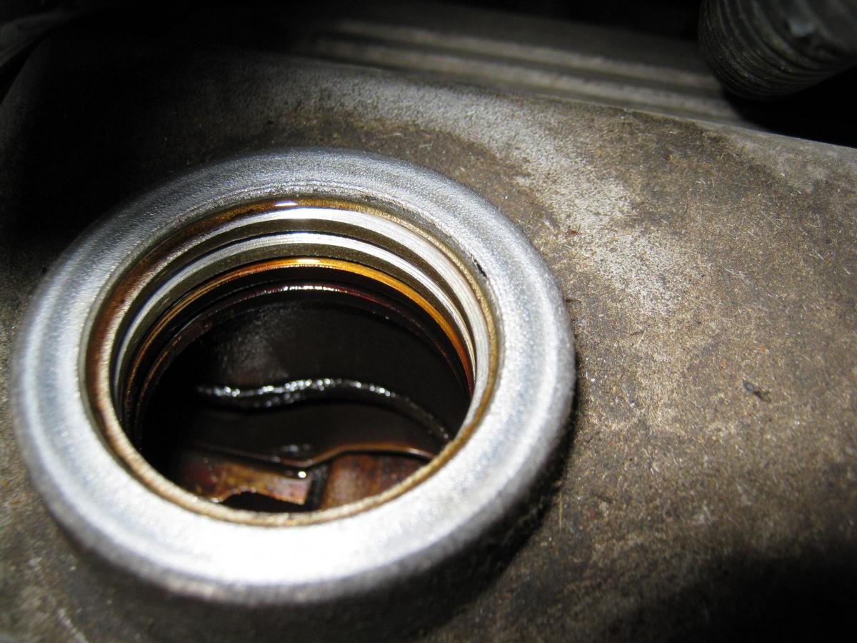

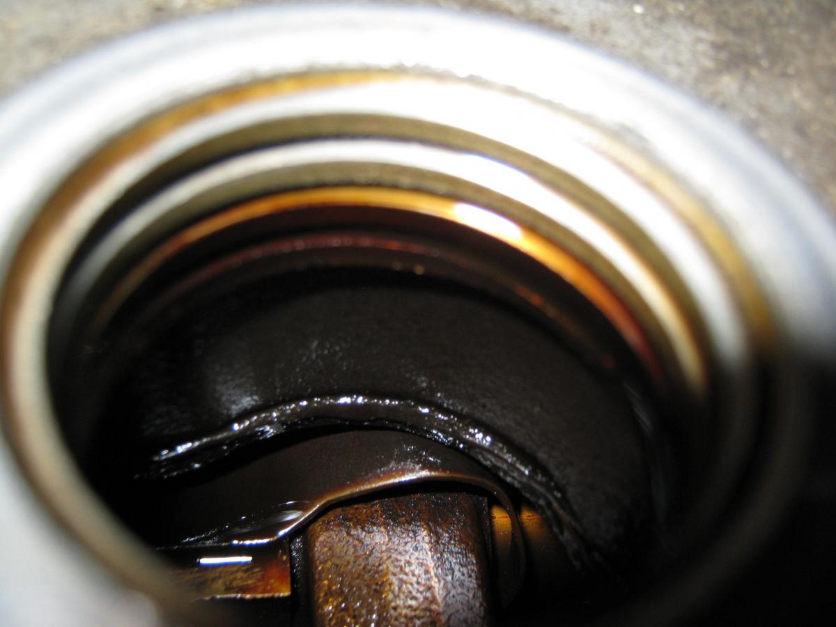

augustinionut Posted September 2, 2013 Share Posted September 2, 2013 (edited) Ca nu era sludge Erau depuneri carbonizate pe supape si cap pistoane, care s-au curatat cu varful surubelnitei. Scuzati calitatea, voi face poze si ziua. Astea-s dupa 20 mii km si un an. Edited September 2, 2013 by augustinionut Link to comment
Tonyus Posted September 3, 2013 Share Posted September 3, 2013 (edited) Hm, al "meu" la 85 mii arata asa. Doar o intrebare, cat mai ai pana la schimb de ulei? Presupun ca pozele sunt recente. Edited September 3, 2013 by Tonyus Link to comment
augustinionut Posted September 3, 2013 Share Posted September 3, 2013 (edited) Pozele sunt de aseara, si am 121747km in bord. Schimbul a fost facut la 120 mii fara un pic(http://www.gmclub.ro/forum/index.php/topic/27606-matzu/?p=572122). Edited September 3, 2013 by augustinionut Link to comment

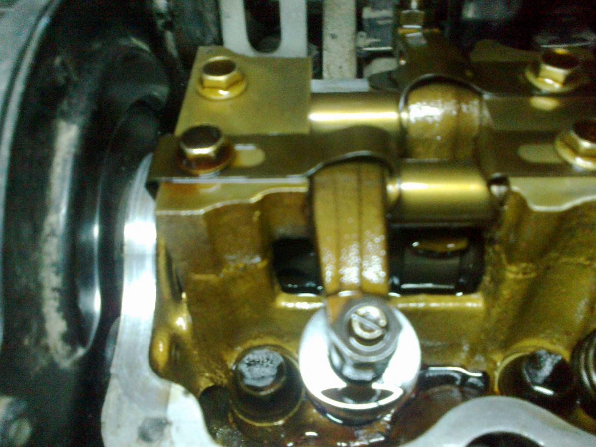

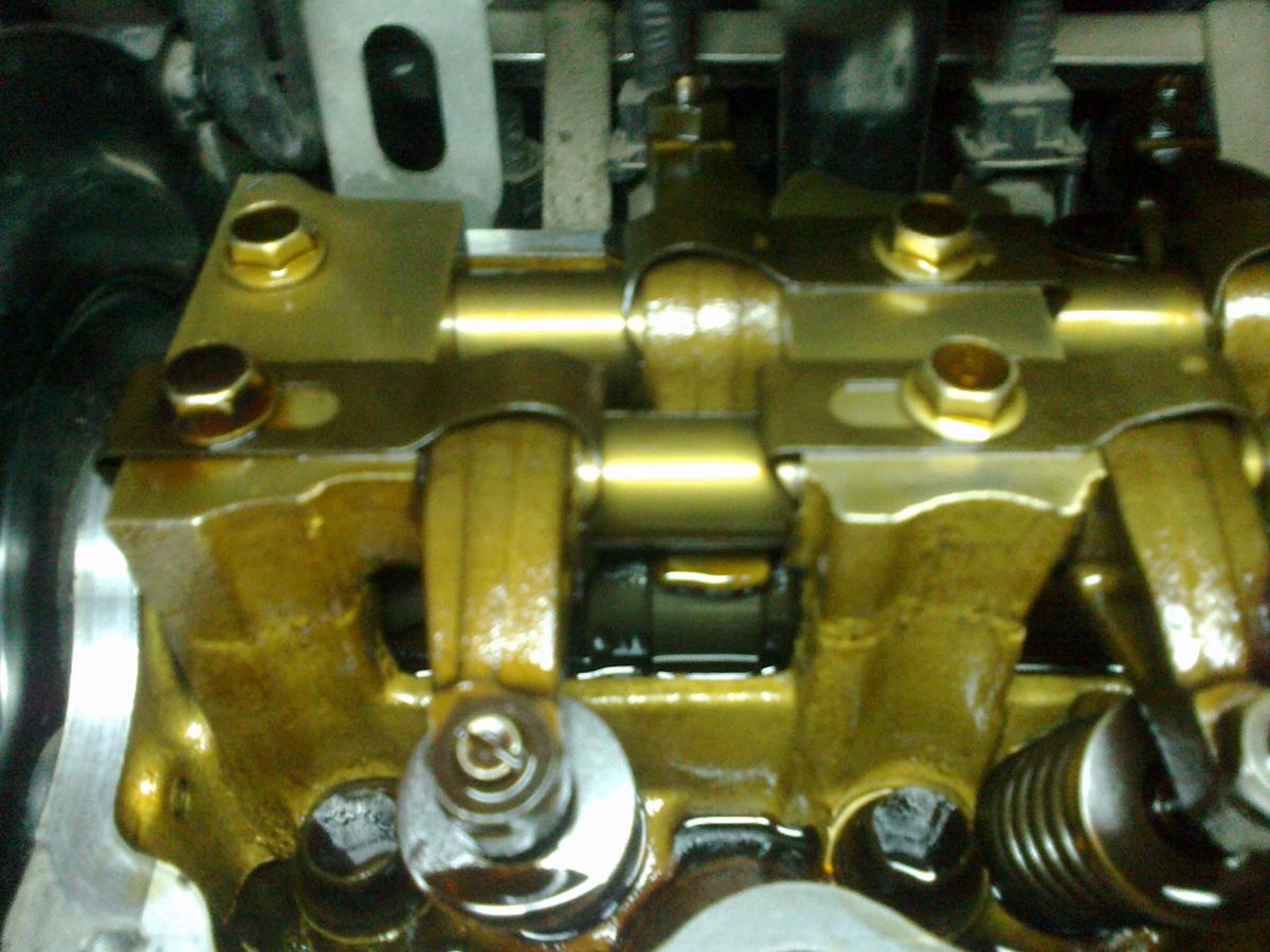

Tonyus Posted September 4, 2013 Share Posted September 4, 2013 Daca tot suntem la poze, uite am facut si eu cateva, cu ocazia schimbarii garniturii de capac (cealalta garnitura nu era buna, curgea ulei pe langa ea). 85.000 km , schimb ulei facut de doua zile. Link to comment
cris06 Posted September 4, 2013 Share Posted September 4, 2013 Frumos, parca e poleit! Ce ulei si, ce masina? Link to comment
Tonyus Posted September 5, 2013 Share Posted September 5, 2013 Ulei Castrol, masina Matiz 2007 E4. Link to comment
cris06 Posted September 5, 2013 Share Posted September 5, 2013 Da' greu scrii... Castrol de care? 5W30? Numai cu asta ai mers? Link to comment

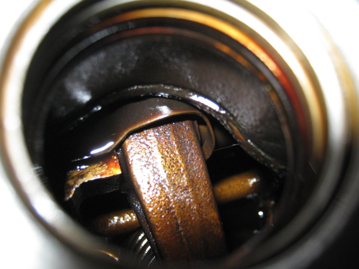

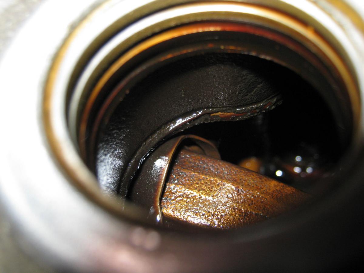

x86 Posted September 5, 2013 Share Posted September 5, 2013 Ca tot se pun fotografii, asa arata chiulasa cand am luat masina. Pe la ~114 mii km. Cred ca a fost folosit ulei mineral ieftin si nu l-a schimbat la timp. Link to comment
Tonyus Posted September 5, 2013 Share Posted September 5, 2013 (edited) Am mai vazut asa motor de Matiz. Era al unui pusti care cheltuia mai repede banii pe scaune "scoica", arcuri sport, etc. decat pe ulei bun si schimbat la timp. @ cris06: Castrol Magnatec 10 w40 si ocazional 5 w40. Ulei 5 w30 a vazut doar la primul schimb ( ~1000 km). Am mai folosit si Aral, dar nu mult timp. Parerea mea, Castrol e mai bun, si la cantitatea necesara, nu e nici foarte scump. Max. 150 - 200 RON/ schimb, incluzand ulei (Castrol) si filtre (MANN, KNECHT). Filtrul de ulei MANN are carcasa filtrului mai mare ceea ce rezulta in suprafata mai mare al elementului filtrant. Dupa doua schimburi de ulei (si filtre) si doua mici probleme de garantie, toate reparatiile/reviziile au fost executate de mine. Edited September 5, 2013 by Tonyus Link to comment

cris06 Posted September 5, 2013 Share Posted September 5, 2013 (edited) @ Tonyus: ai folosit Castrol Magnatec din comertul nostru "multilateral dezvoltat"? Al meu motor a fost uns vreo 5 schimburi cu Magnatec 5W40 (10.000 km si max. 6 luni) si vreau sa-ti spun ca mi-a lasat o mazga de toata frumusetea! Ori o fi fost contrafacut (desi asta il aveau la reprezentanta Dw folosit in garantie), ori nu a fost uleiul potrivit. Cert e ca si colegul Uskt a vazut exact acelasi lucru in motorul lui. Despre Aral am mai povestit si nici nu vreau sa aud de el. Oricum, cred ca e aceeasi mancare de peste, intrucat sunt facute de BP. Ce sa zic? Felicitari! Edited September 5, 2013 by cris06 Link to comment
Tonyus Posted September 6, 2013 Share Posted September 6, 2013 Pai da, din comertul nostru am achizitionat uleiul. Doar o presupunere, 5 w40 zice ca e full sintetic iar 10 w40 doar partial sintetic iar acum ceva timp am citit undeva despre uleiuri de motoare, cum ca cele semi sintetice ar avea detergenti in compozitie sau in proportie mai mare decat cele full sintetice. Uleiurile cu cel mai mare procent de detergenti ar fi cele pentru motoare diesel. Motiv lesne de inteles, ele produc cea mai multa "mazga". Link to comment
ches Posted September 9, 2013 Share Posted September 9, 2013 Un ulei cu mai multi detergenti curata motorul, lasandu-l curat. Doar uleiul se murdareste. Motorul meu arata exact ca al lui x86 la ~84000km. Dupa o curatare in zona culbutorilor urmata de un motor flush, curatare baie de ulei si schimb de ulei si filtre arata mai bine decat al lui Augustin . Sa vedem pentru cat timp. Am folosit ulei GM 10W40 si 1/2 de sticla de aditiv Visco Stabil de la Liqui Moli. Dupa aprox 1000km am vazut ca nu mai papa ulei. Vechiul ulei, tot GM 10W40, dar la bidon de 5l imi parea a fi contafacut. Sa speram ca i-am dat de cap si cu consumul de ulei. Link to comment
