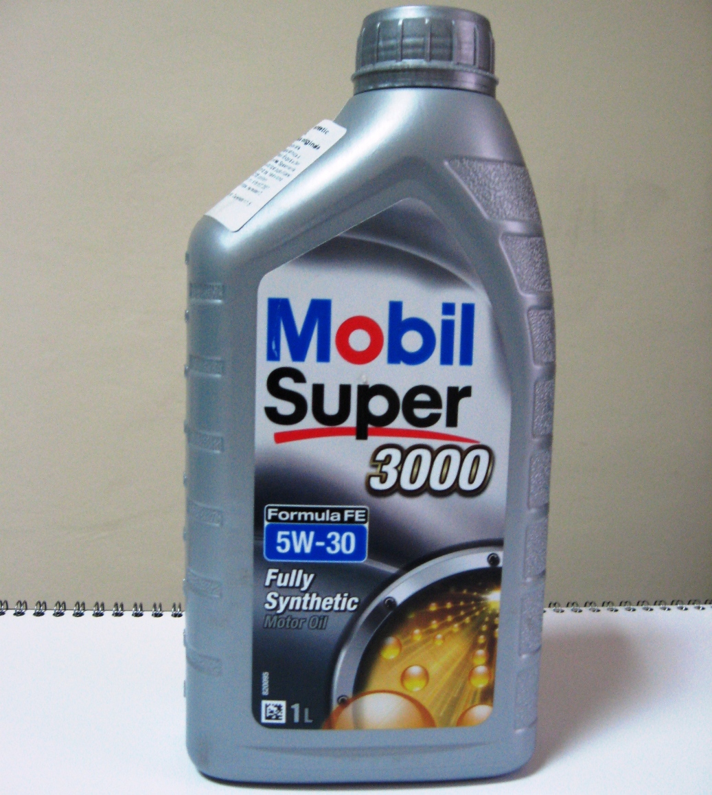

sorinm Posted October 19, 2010 Share Posted October 19, 2010 (edited) La moda acum vad ca e Mobil Super 3000 FE, din asta am pus in motor de 2 revizii incoa, ce parere aveti despre el ? http://www.oilmag.ro/uleimotor/images/mobfe.jpg Vascozitate: SAE 5W-30 Performante: API SL/CF, ACEA A1/B1, ILSAC GF-2 Aprobari: FORD WSS M2C 913-A / 913-B Edited October 19, 2010 by sorinm Link to comment
tolin Posted October 19, 2010 Share Posted October 19, 2010 Ala-i ulei pentru motoare FORD (ACEA A1/B1), strici motorul daca-l bagi in cel de Matiz ! 2 Link to comment
sorinm Posted October 19, 2010 Share Posted October 19, 2010 Asta mi-au bagat desteptii de la Raver (fost dealer daewoo, actual dealer kia) Constanta la penultima revizie. Le-am cerut ulei Mobil si in loc de Mobil Super S traditional mi-au pus din asta. Culmea ca merge bine, nu a papat deloc ulei, iar acum i-am bagat din asta iar. 1 Link to comment
argon Posted October 19, 2010 Share Posted October 19, 2010 Mai asteapta, e pe termen mediu-lung, nu scurt. 1 Link to comment
tolin Posted October 19, 2010 Share Posted October 19, 2010 Da-l afara urgent, iti termina lagarele de alunecare (cuzinetii). 1 Link to comment
sorinm Posted October 19, 2010 Share Posted October 19, 2010 (edited) In manualul de matiz recomanda certificare API SJ, iar acest ulei are certificarea API SL, urmatoarea generatie. SL- For 2001 Gasoline Engine Service Recommended for gasoline engines in passenger cars and light trucks starting in July 2001. SL oils are engineered to provide improved high temperature deposit control and lower oil consumption. Applications specifying API SJ can use the new API SL service classification. Note that some SL rated oils may also meet the latest ILSAC specification and/or qualify as energy conserving. SL is the latest specification. Il las, e cam criza in buzunare, macar 5000 Km... Alta sursa For automotive gasoline engines, the latest engine oil service category includes the performance properties of each earlier category. If an automotive owner’s manual calls for an API SH or SJ oil, an API SL oil will provide full protection. Edited October 19, 2010 by sorinm 1 Link to comment
tolin Posted October 19, 2010 Share Posted October 19, 2010 (edited) Las-o asa ! Cand oamenii iti spun (cateva pagini in urma) ca la motoarele astea este nevoie de ACEA A3, pe langa API SJ, minim. Producatorul uleiului iti scrie ca-i pentru Ford. Cine dracu m-a pus sa raspund ? Promit, n-o sa se mai repete. Edited October 19, 2010 by tolin 2 Link to comment
sorinm Posted October 19, 2010 Share Posted October 19, 2010 Calm, apreciez raspunsurile dar nu prea am ce face momentan. Multumesc mult pentru promptitudine. 1 Link to comment

sorinm Posted October 19, 2010 Share Posted October 19, 2010 (edited) M-am mai uitat inca o data pe bidonul de ulei, e ala..Mobil 3000 FE pentru Ford, nu stiu ce sa fac, ma apuca dracii cum fosta reprezentanta si service oficial Raver mi-au bagat la penultima revizie uleiul ala si acum la ultima revizie de 200 Km,tot un fost service Daewoo (Auto Haus Tudor) cand le-am cerut Mobil 5w30 mi-au pus tot dracie din asta cu specificatii Ford si ACEA A1/B1. Si ce e mai grav, magazin "de prestigiu" in materie de piese Daewoo, la Delfinariu, pe partea dreapta, sensul dinspre Constanta catre Mamaia are expus exact uleiul asta si-l recomanda tuturor. Nu stiu ce sa mai cred, o sa strang buzunarul si o sa imi caut eu cu mana mea ulei si filtru si o sa ma *** pe cartea de service si o sa mi-l schimb eu de acum incolo. Inca am factura de la AHT in care scrie clar ca mi-au pus Mobil super 3000 FE, sa ma duc sa le fac gargara ? Am vre-o sansa de castig ? Poate or sa imi dea cu manualul in cap unde scrie ca trebuie doar API SJ, iar uleiul e API SL , deci e superior si treaba e buna dupa ei. Ce ulei gasesc pana in 35 RON litrul si sa respecte specificatiile matizului ? API SJ minim si ACEA A3/B3 ? Probabil o sa iau de la Total Quartz sau Castrol. Edited October 19, 2010 by sorinm 1 Link to comment
argon Posted October 19, 2010 Share Posted October 19, 2010 (edited) Trecand peste norma necorespunzatoare, cum poti sa pui in Daewoo un ulei pentru Ford? ori pui ulei Daewoo, ori ceva universal gen marcile cunoscute. Sau e pe principiul daca e de ford e bun? Edited October 19, 2010 by argon 1 Link to comment
