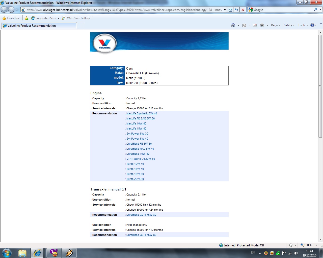

cristics Posted December 19, 2010 Share Posted December 19, 2010 (edited) ... Ma bucur ca folosesc ulei pentru motoare FORD fftopic: In locul tau as baga de Ferrari... sau , tot de pe lista de la valvolineeurope,care e data aiurea, poti sa bagi si VR1 Racing Oil 20w50... cred ca ai putea sa fi putin mai selectiv. Edited December 19, 2010 by cristics Link to comment

cristics Posted December 19, 2010 Share Posted December 19, 2010 Vreau sa va conving sa folositi ulei de Ford atat timp cat FE inseamna ford engine ) Nu poti, dar vad ca te straduiesti. Ai vazut listarea de mai sus de la valvolineeurope?! Sigur e o problema acolo...pentru ca pe valvoline.com.ro arata altceva si e pacat sa bagi un ulei nerecomandat Matiz-urilor din Romania. fftopic: Chestia e ca nu esti convins daca ai bagat bine sau nu uleiul, ca de aceea insisti. Cei ca tine ma fac sa-mi intaresc ideea sa nu cumpar masina la mana a II-a din Romania. Nu o lua personal... Link to comment
argon Posted December 19, 2010 Share Posted December 19, 2010 ACEA A1/B1 oils are Mainline lubricants. They are designed for use in gasoline and light duty diesel engines that have been specifically designed to use a low viscosity oil. ACEA A1/B1 oils are typically used in older vehicles as they do not provide the minimum performance demanded by the latest OEM specifications. These oils may be unsuitable for use in some engines. Prior to ACEA 2008, ACEA A1/B1 was usually coupled with the Ford specification, WSS-M2C913-B. However, a new edition of this specification has been introduced by Ford which requires a higher minimum ACEA performance level of ACEA A5/B5-08. This will further reduce the range of applications for which ACEA A1/B1-08 oils are suitable. http://www.lubrizol.com/EuropeanEngineOils/A1B108.html Link to comment
